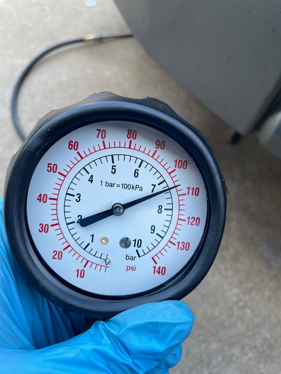

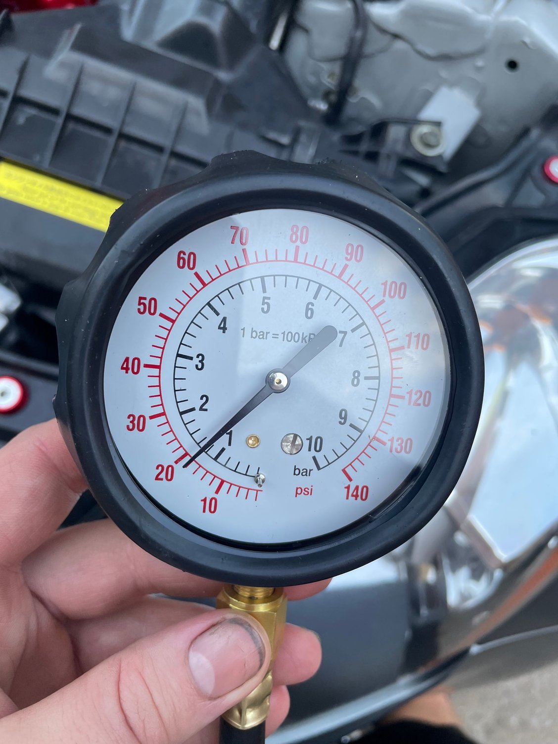

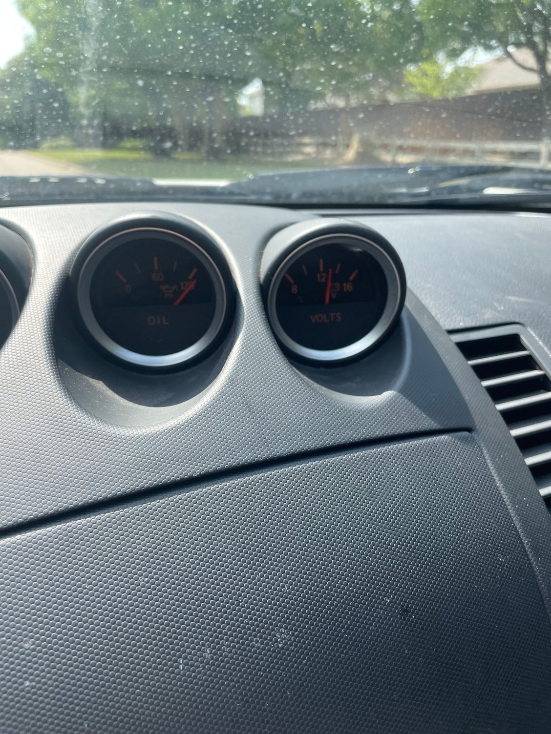

Ok got the mechanical gauge setup and it’s definitely the oem gauge or sensor. I used the port after the filter so pressure is likely lower than what the sensor should be seeing. probably going to switch to a 0w30 oil to help with the high initial pressure
Startup about 106-108psi
At temp 18-15 depending on idle

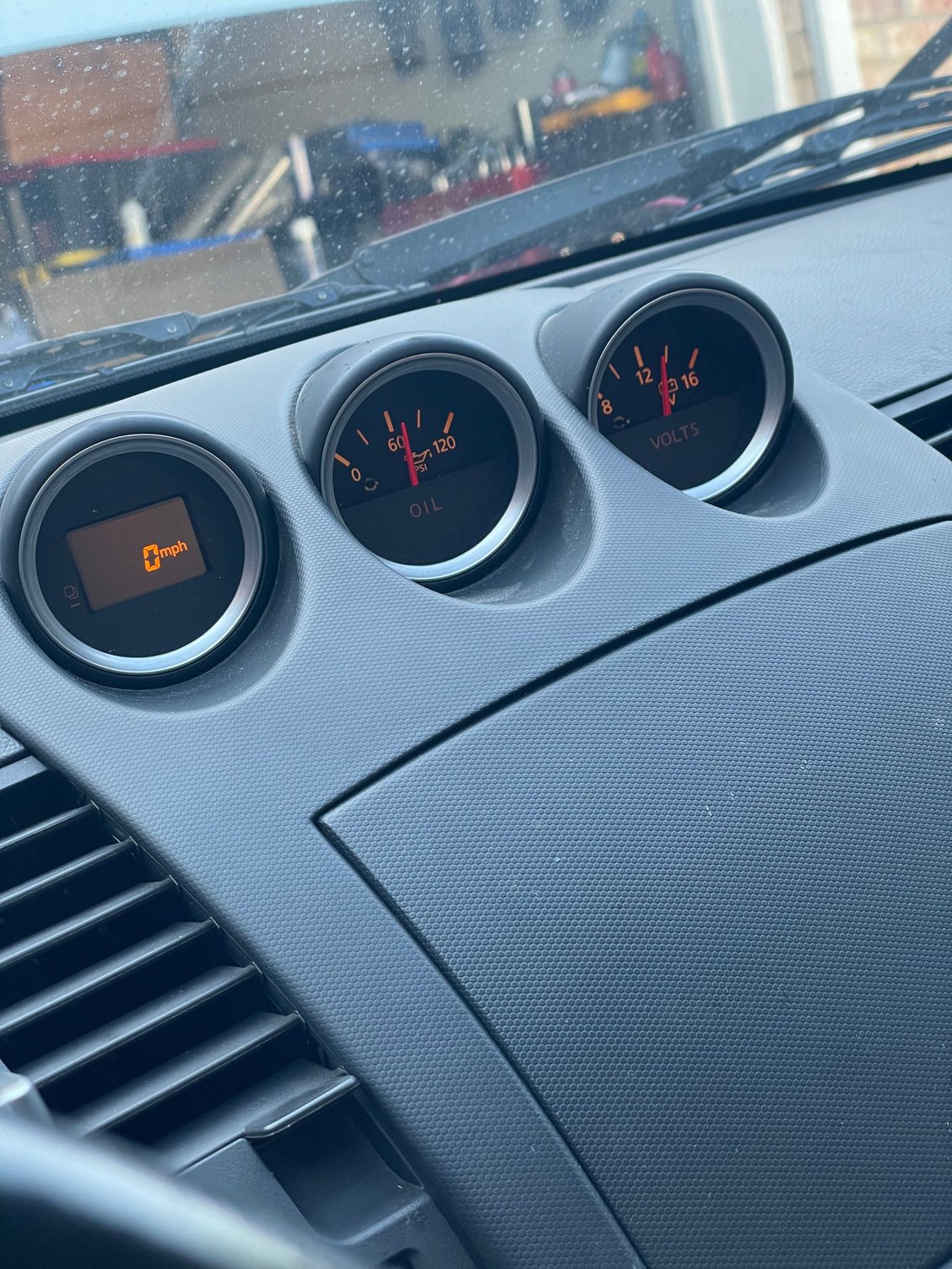

For got to post the oem gauge readings for comparison, it’s possible this is actually what it’s seeing pre filter but I needed the piece of mind of the mechanical gauge, I’m running the 108 filter right now and will switch to the 110 filter when I go to 0w-30 also still not sure why the gauge was showing almost zero earlier in the week unless the sensor really is going bad
Startup
After warmup

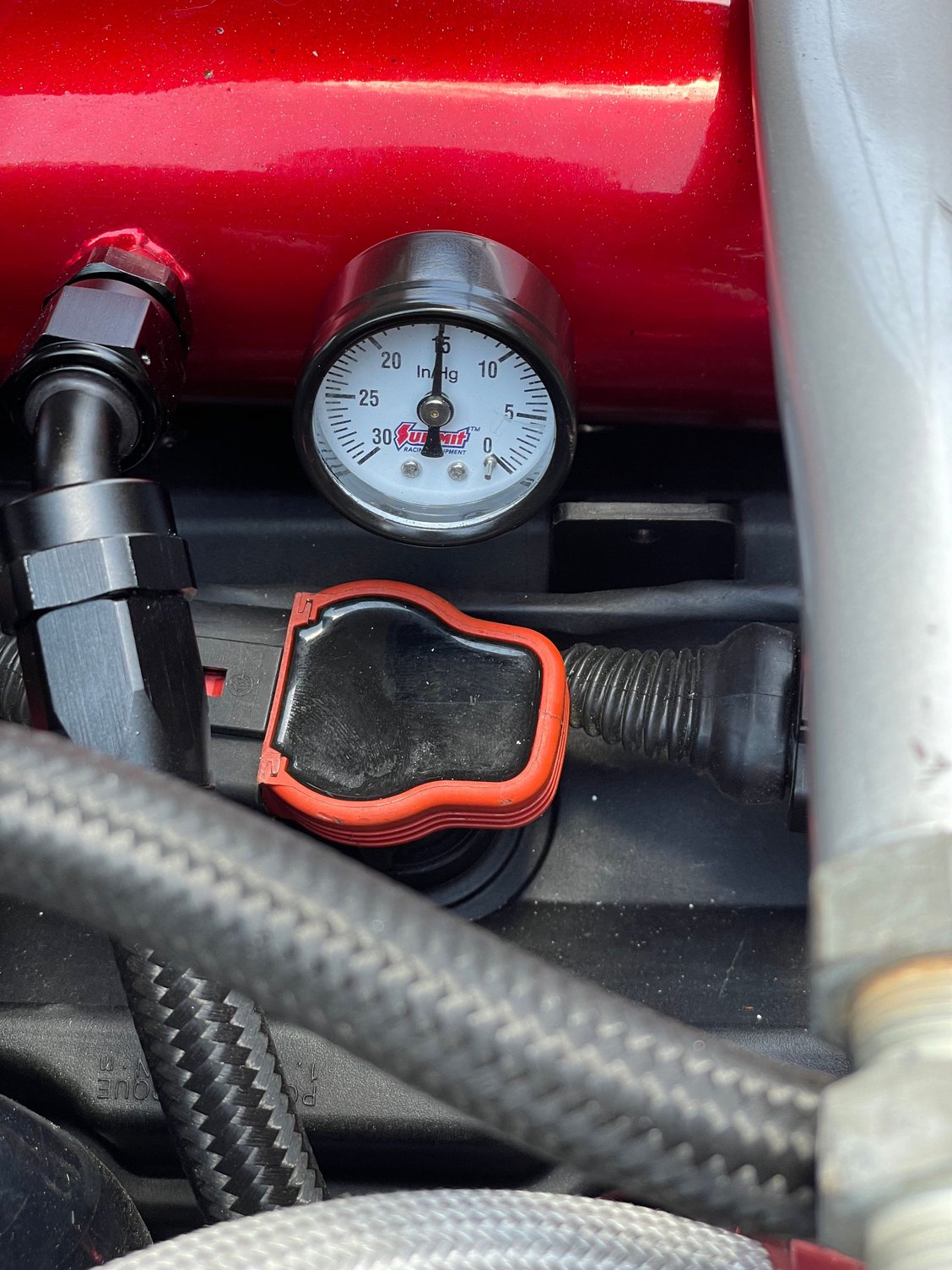

Changed the oil and filter now ruin 0w-30 and the m1-110a filter and it is much happier with a cold starting pressure I’m much more comfortable with. I took the time to remove the sensor and clean the connector and wiring with contact cleaner and put a bit of anti-corrosion contact grease on the connector still didn’t do anything, but I think I have an idea of what’s going on. I noticed when I switch the ignition to the on position before cranking the gauge runs up to 60. Also the battery keeps running down and I keep getting the p1235 code for throttle sensor voltage correlation. So I’m wondering if I have a grounding issue again. I haven’t modified the harness since last time so it might be how I have the engine and battery grounds setup. It’s too hot out now for any additional work so I’ll wait till Tomorrow morning to take a look at it and then report back what I find
un-related: does anybody know what the normal vacuum at idle is? I installed a small vacuum gauge on the manifold and am just curious, I’m reading 15-17 In/Hg

Yea - likely the sensor … the sensor goes straight to that gauge and I dont know that I’ve ever seen anyones gauge go out.
It seems like I replace those pressure sensors every 15k to 20k miles or so … recently I purchased an AEM stainless steel sensor and I re-wired the connector to the delphi style. I hope this has better longevity.
14-15in-hg sounds right …

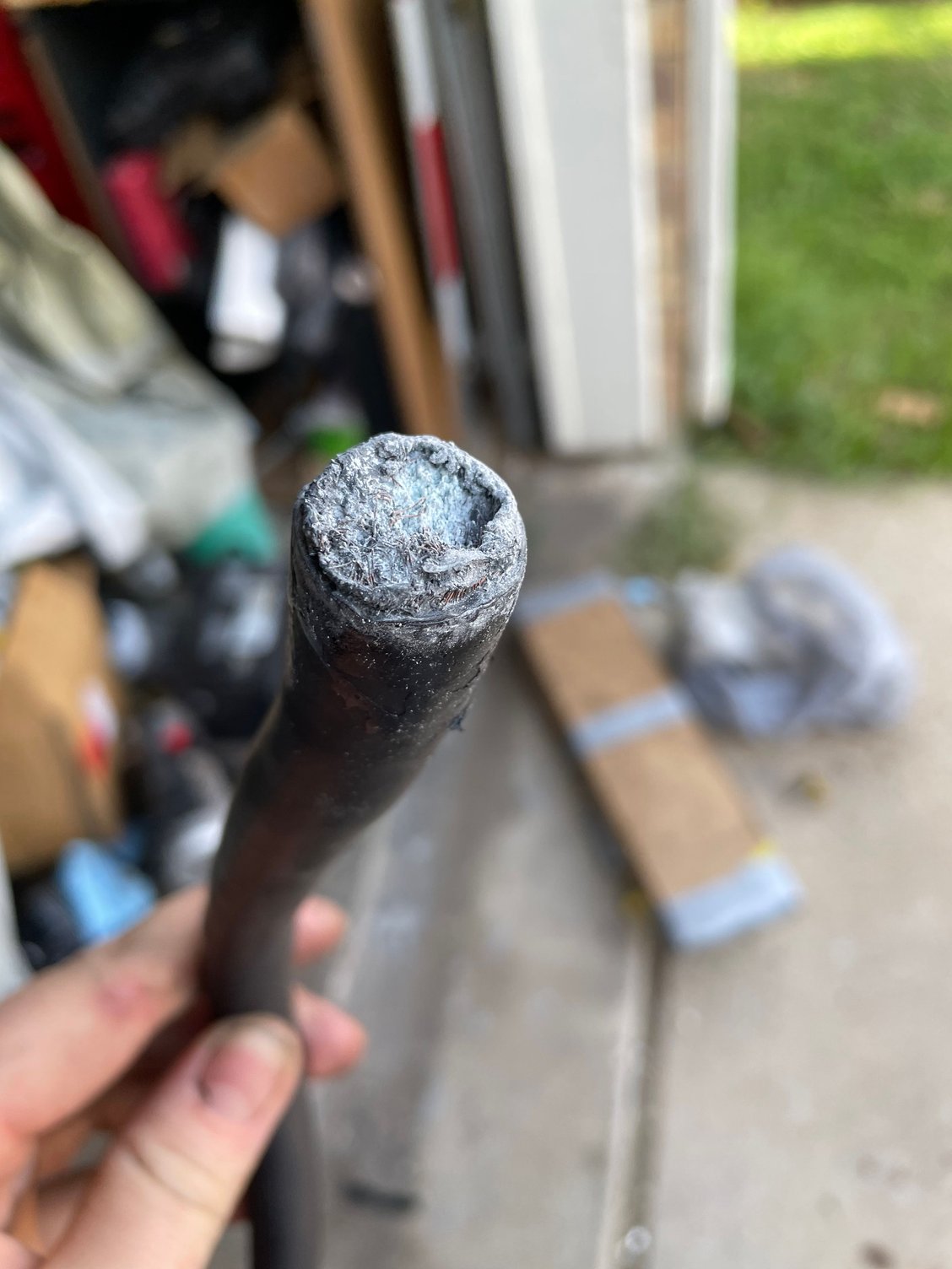

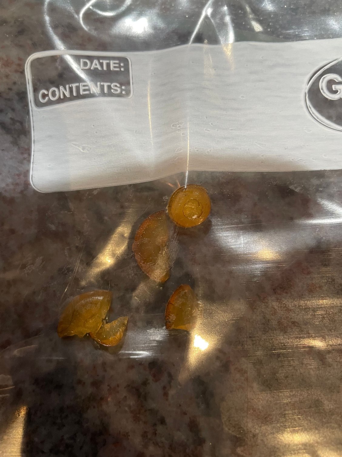

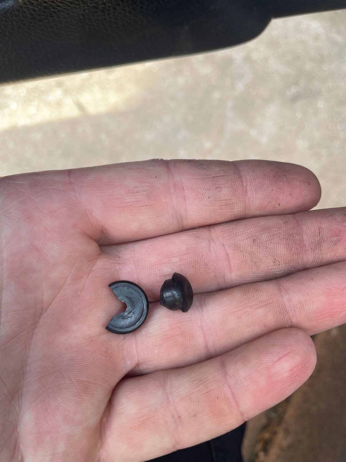

Well today I solved a few problems and found a few problems I’ll start with the boring stuff first, for those fortunate enough to not live in Texas it reached 110 Least week here in the DFW and for that matter much hotter inside sitting vehicles. I think that’s where a few of my issues originated from. Confused? I’ll explain, first I found some plastic parts on the floor under the pedals
these ended up being the switch grommets that contact the brake light switch and the clutch switch. My brake lights have been running continuously which explain the battery constantly draining. Then I had problems with the car not starting due to the clutch switch grommet crumbling currently I have bolts in place as a temporary fix.

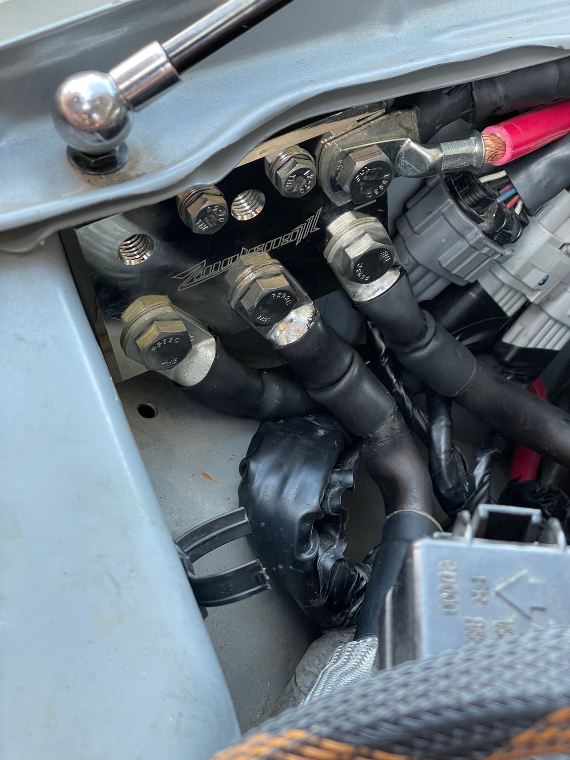

now for electrical, I decided to install a single grounding point right off the OEM spot next to the battery, I think it came out nice and found the nasty problem causing the P2135 code. As I disassembled the old ground setup I came across the cable that grounds the chassis to the battery. It was badly Corroded, so bad in fact that it broke in half. Not sure how that happened since it was a 0/1 gauge wire I installed to replace the tiny oem 6 gauge one, but it’s been replaced with a much nicer cable with measures to prevent future corrosion. All reassembled with the new cable and grounding setup the P2135 code went away and the oil pressure gauge is reading closer to actual pressure, the idle is also significantly better
New grounding setup
Old battery cable
Im going to order all new pedal grommets from Z1 this week including the accelerator pedal and just have piece of mind

I like that grounding block - looks clean!
