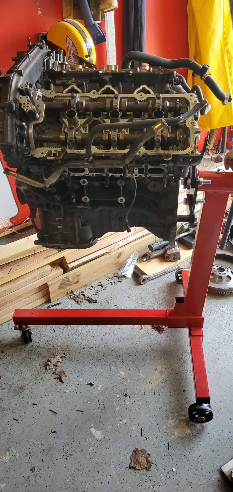

Found a really good deal on Manley rods due to store overstock. these should hold up to my goal. I am also considering instead of fabbing my own headers to just do a front mount and use the Jim Wolf Technologies Headers i can purchase and toss the turbos i bought as i believe they should fit ( i have to do a little more research). I also may just do a whole tubular front end as i have a buddy who owes me a big favor.

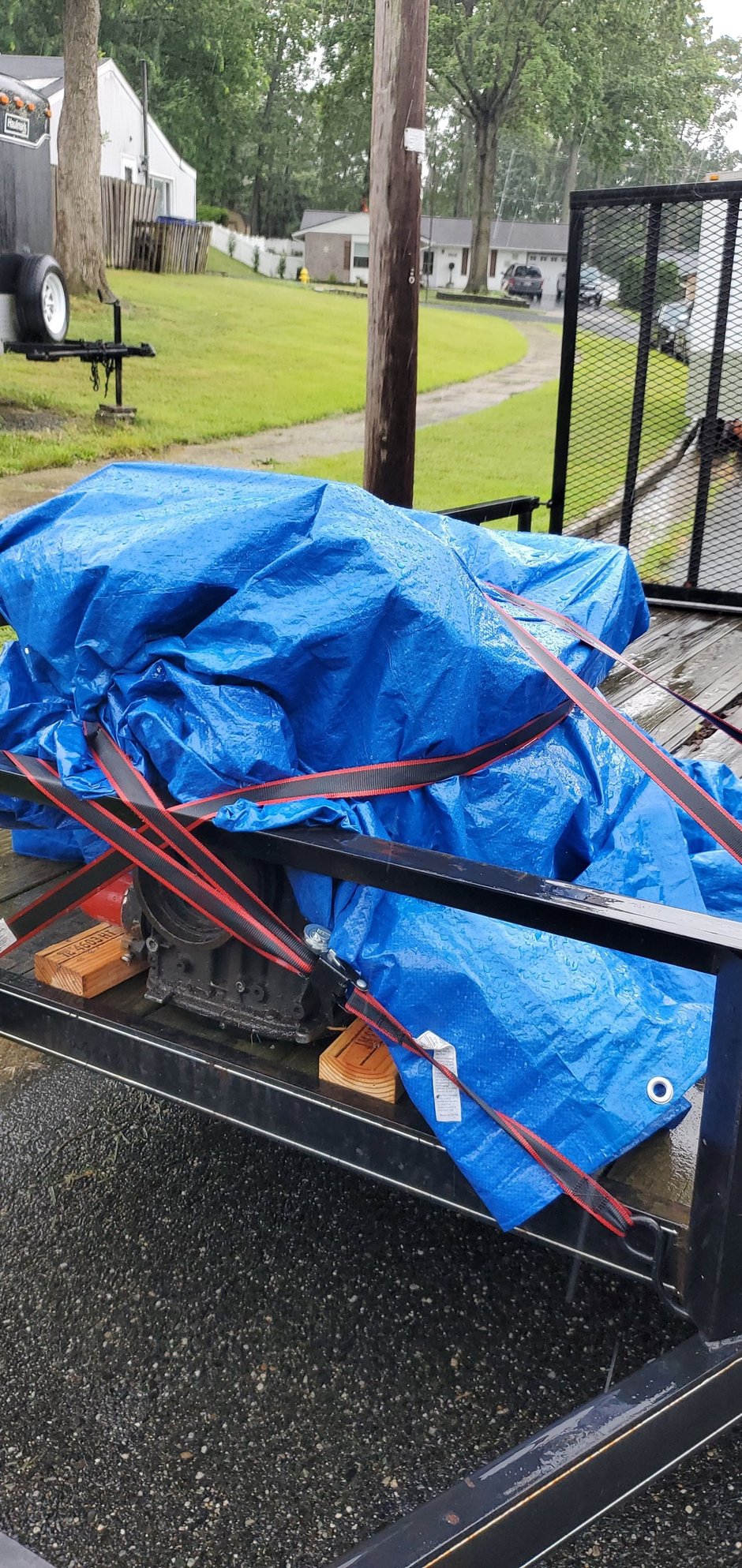

Also update I got the engine up on a stand and drove all the way from NJ to MD and had to wait for some help from friends to get it up on the stand. Going to be tearing apart and then getting the bottom end sent out to be built and machined.

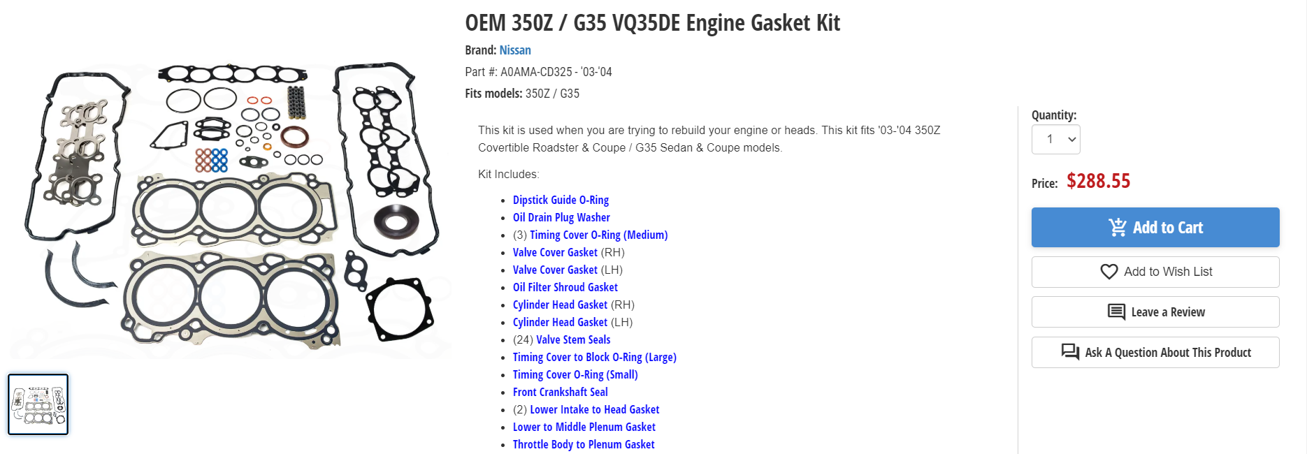

Flame me if it is deserved, but i am rebuilding a used motor to put in my car as previously stated and i was looking for a full gasket set/kit and i found one on ebay about a half to a third of a price of the one on other Z performance based websites. could these gaskets be used or should i say screw it and buy the gasket kit i know would be at least oem quality.

You’re looking at 1200$ rods but trying to save 200$ to get no-name gasket sets?

Yep. Get the right gaskets.. there are no shortcuts in this business.

Plenty of shortcuts ... just none that will take you where you want to go!
yea, Z1 is three times as much but theres a reason (ie they use legit stuff), you get what you pay for, and support the companies that support our platforms.
+1 to what Abog is saying ...
