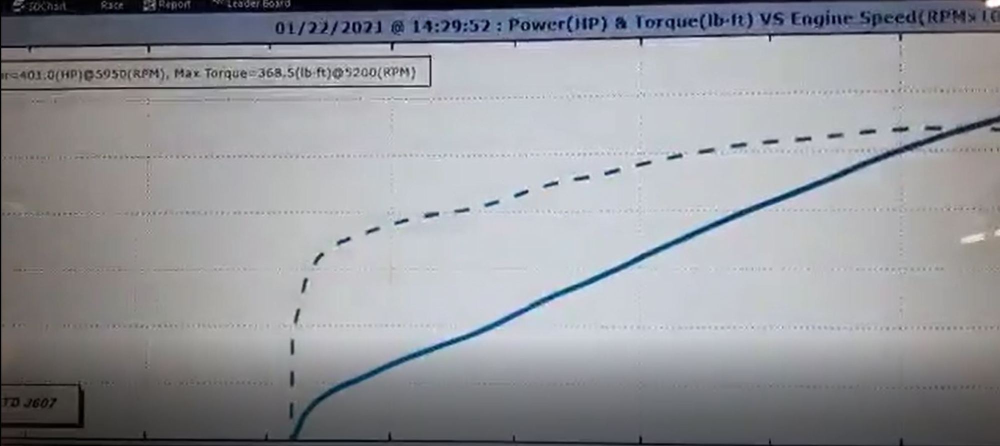

Hey all, since I posted here with a few questions along the way, thought I would post the dyno video and results on Premium and E85. Running a Vortech with a 3.12 pulley, 750cc, AEM 340 fuel pump and a bunch of upgrades. I am just about to get the car back and already thinking about the 2.87 pulley. LOL I talked about it with the garage when they were doing the tune and we were having some boost issues (loose belt), but thought I would go conservative for now. The interesting thing is I have heard keep the torque below 400ft lbs for the rods. Someone was posting their numbers on stock DE motor like mine and was over that with about 483hp. Seems super high to me. I did some reading and some were pointing out it was the Detonation that they believed was the bigger factor in killing the engines. Which is somewhat solved if you are running E85 which I plan to do. Just thought I would get some opinions here rather than the facebook crowd. I realize the answers are subjective by nature given the many configurations and risk tolerance. Click on the attached file below to see the dyno run. Notice how the guy outside the car takes a few steps back from the engine as he really starts to lay it on. LOL
E85 401whp
Premium Fuel

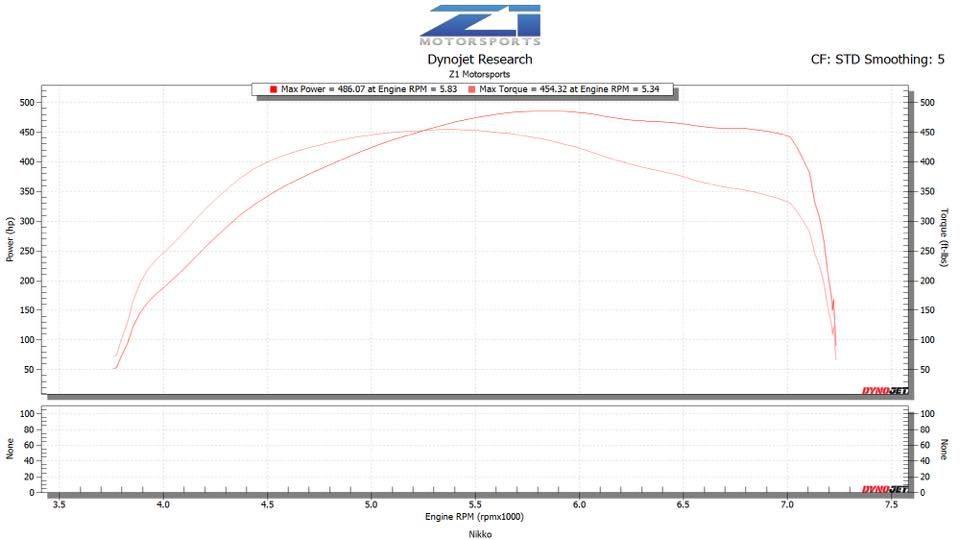

For comparison, this is what this guy is saying is setup his on a standard DE motor(not built). Not sure I could sleep at night running something like this?
Hey, I just really noticed his RPM's and he is going up to and past 7k. Can't be a DE right?

Thanks. Yeah, I set it up to run premium fuel or E85 as there is a pump only 1.5 miles from my house. The interesting thing is the E85 fuel is about 1/2 the price of the Premium. Should be fun to drive it around and then really test it on the Autocross this spring and see if it holds up ok. Still mainly a weekend car and maybe some day post Covid etc. I will try running it at the track.
The picture of the E85 401hp was early on. I think he may have gotten another 5 or 10hp out of her.

E85 also uses more fuel so there won't be a difference as far as running price. DE can rev to 7k but I wouldn't do it often, I believe that's what my redline is set to. I'd talk to Tim since he seems to be the Vortech guru here, but if it were my car I wouldn't want more than 350wtq just so I can actually USE that power and sleep at night like you said lol.
Also one thing to note, there is a reason you don't see people running boosted VQs very often if it's for road race/auto cross they are quite fragile for that due to heat so be careful and keep an eye on oil and coolant temps.

So, that means the guy with the chart I posted is right up there in the failure area without a doubt. Must have been a blast to drive up to the point of explosion. How long did you run it like that?
Do you agree that Detonation plays a large role in the point of engine failure with these engines? This why the E85 is better to run in them with the higher HP and torque? Just curious about it.
