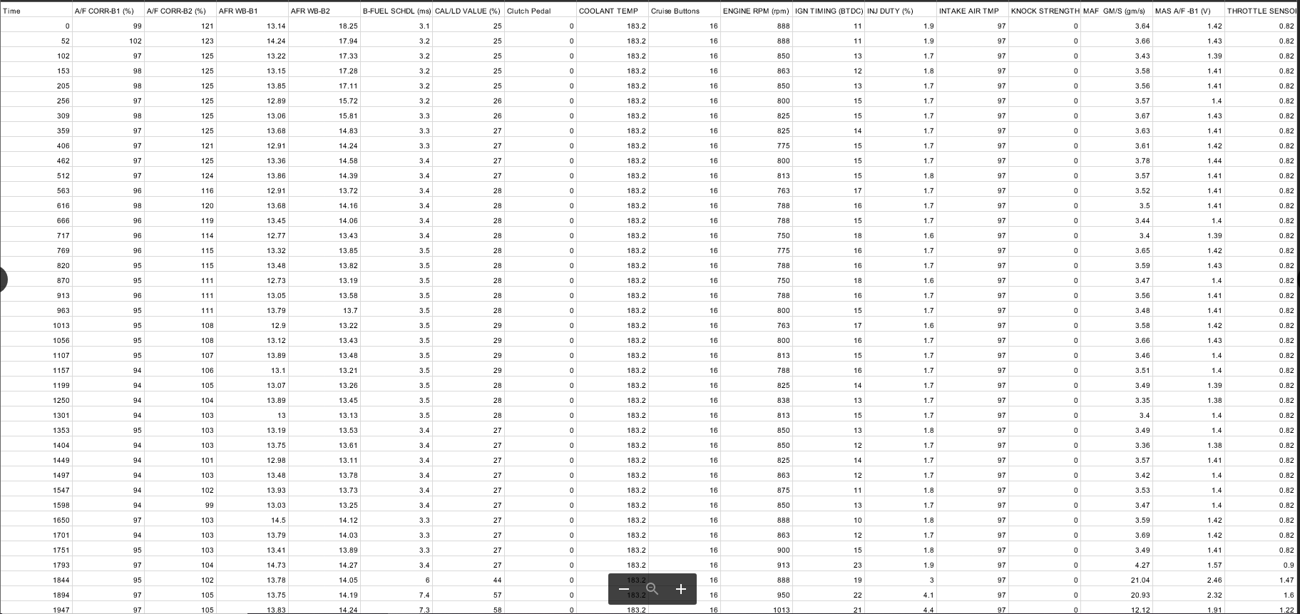

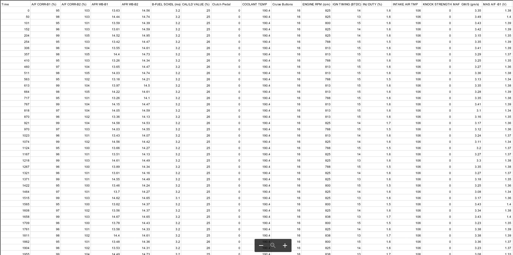

Hey everyone, So I'm at a loss not able to figure out this problem and wondering if anyone has had similar issues?
So, I'm trying to get my car tuned right now with this setup:
Rev 9 turbo kit
Cx racing turbo t3 .60 .63 a/R
Tial 38 mm wastegate 10 psi spring
black flag 255lph fuel pump
630/660cc Bosch injectors
Greddy Rs race single exit
Uprev MAF GT
Aluminum Maf Housing 3" Outside Diameter/ 2.75" Inside Diameter
UpRev Tuner
Basically what is happening is under WOT bank 2 especially says its lean goin upwards of 20 A/F having major bank to bank variance after I put a new motor in from Japan. My tuner said that it was an exhaust leak or a vacuum leak but after going through everything on the car their are no apparent leaks anywhere we also compression tested the car with all cylinders 145+ Although my tuner said this when I had this same issue on idling, but they then got it to idle without the bank variance. I'm at a loss at this point thinking it may be a bad fuel pump, after swapping injectors to the other bank to see if the issue would switch banks. I also have replaced upstream o2 sensors and cam and crank sensors. I ran this similar setup with a rev9 turbo on my old motor before it blew needing a new turbo as well leaving me at a loss, any ideas would be very helpful!
(I'm on a 2nd base tune)
Shortened Logs Pictures Logs
Idle Log
Cruising Log (Short)
3rd Gear Pull (Short)
Here are the logs that were sent to my tuner

I would look into that those values,
I should have looked at your images you posted, didn't bother to after I tried to open your data logs,
but as you can see in the tables I circled, the values should be in the range of 95 to 105, afr cor b2 is at 125 your wb b2 is reading 18.25
its not a cold start up your engine temp is at 183f and your base fuel schedule 7.3 950 rpm
do you know if he scaled the bfs, they need to be scaled a bit when you install bigger injectors, should still be in closed loop at 950 rpm
if I remember right the fuel pressure should be about 55psi
