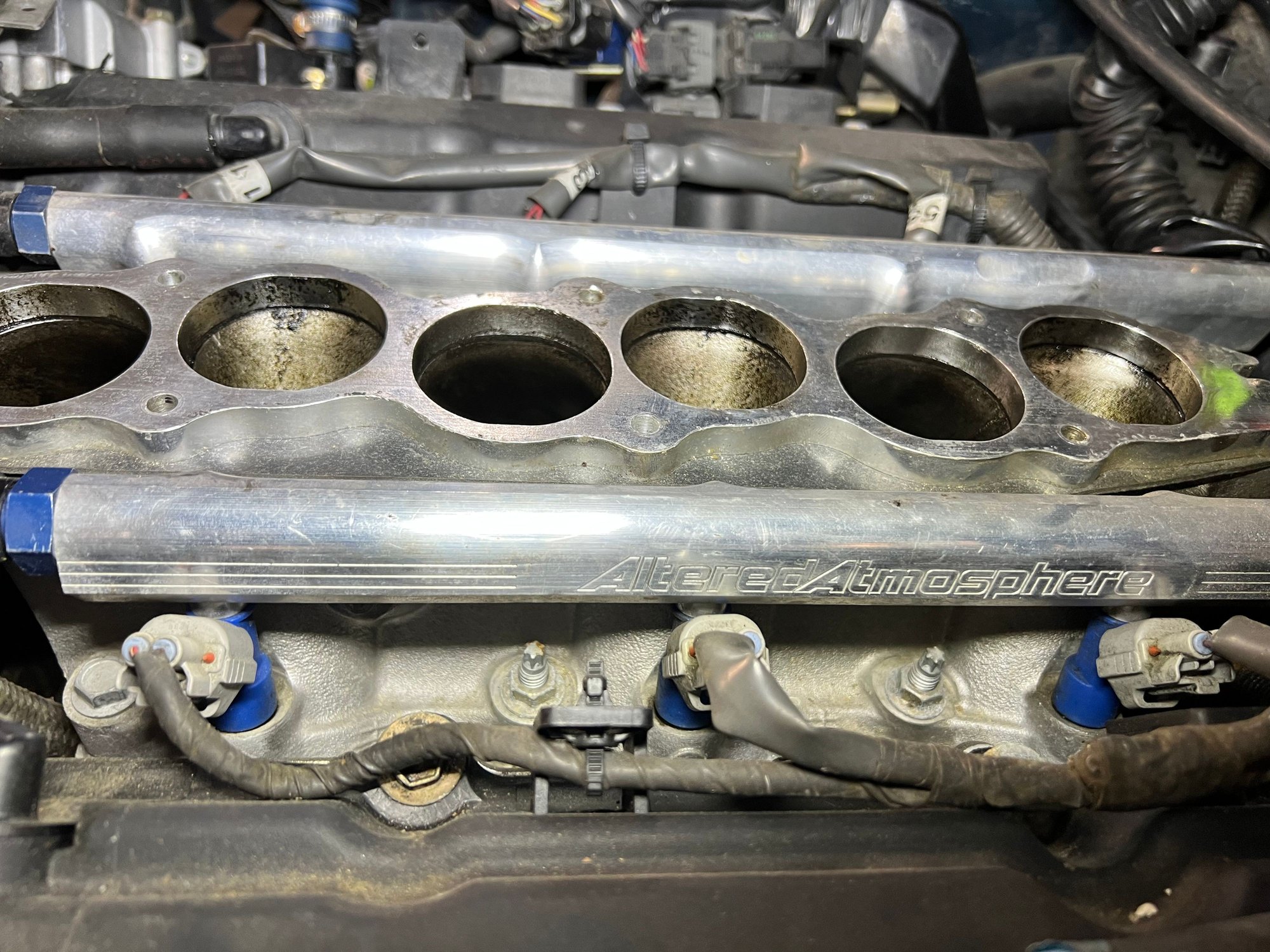

Capped off rear vacuum ports and tried one last BLT before tearing into it.
Still lots of burbling/gurgling BUT slight hissing and fuel smell at driver's side front. Figured it was a leaking injector.
Took plenum off and noticed a gasket in between spacer and block. Now I'm concerned there could be a leak in gasket. It's on there VERY well. Was thinking of trying to saturate gasket with acetone in attempt to remove. Thinking I might throw plugs, clean injectors, and maybe OEM coilpacks before tearing up gasket and perhaps spacer.

The 350Z intake hisses normally. You sure that's not the sound you're hearing? Is the sound louder near the air filter?
Old Apr 3, 2023 | 06:40 AM
eZg's Avatar
eZg
Posts: 975
Likes: 61
From: Nashville/Tupelo
I ain't sure of $hit......that I know.
After pulling the cosworth plenum off, I found a line (larger than vacuum line off rear) running out the bottom rear that I had not clamped off or plugged. Perhaps that was the source of air into liquid noises?!?!
Attempting to research plenum gaskets and proper sealants now as that seems like a possible source of issues. I use a lot of Permatex aviation on an older engine from the 70's I'm working on and it seems like it couldn't hurt between the gasket that is glued to bottom of plenum but has none to top of spacer.
Old Apr 3, 2023 | 06:47 AM
i8acobra's Avatar
i8acobra
Posts: 8,046
Likes: 1,341
From: Phoenix, AZ
Remove the paper gaskets and replace them with two OEM metal gaskets. The cheap paper gaskets that come with the spacers are notorious for leaks.
Old Apr 3, 2023 | 06:53 AM
eZg's Avatar
eZg
Posts: 975
Likes: 61
would you use the Permatex on them?
Thanks for the suggestion!!
Old Apr 3, 2023 | 07:15 AM
i8acobra's Avatar
i8acobra
Posts: 8,046
Likes: 1,341
From: Phoenix, AZ
You could, but it's messy. The OEM gaskets work.
