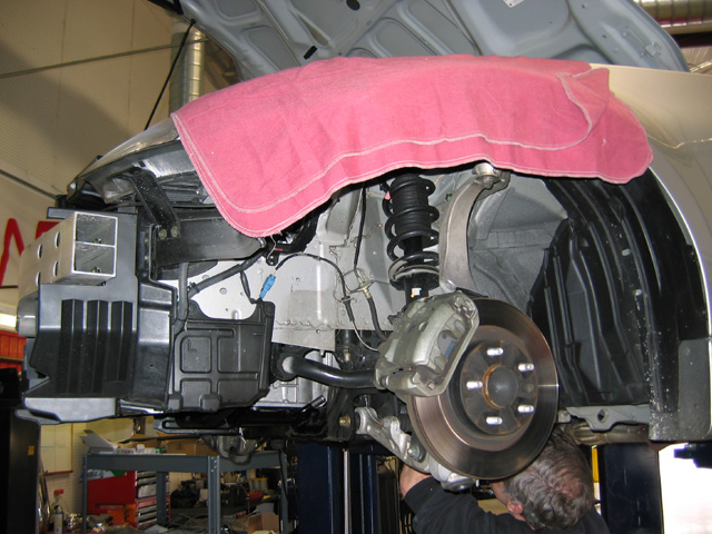

Old Mar 14, 2004 | 03:04 PM
Bini2's Avatar
Bini2
Posts: 798
From: Kansas City, KS

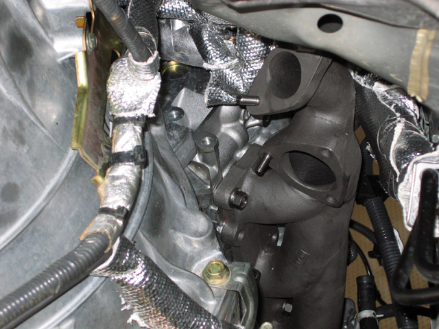

Pic 1

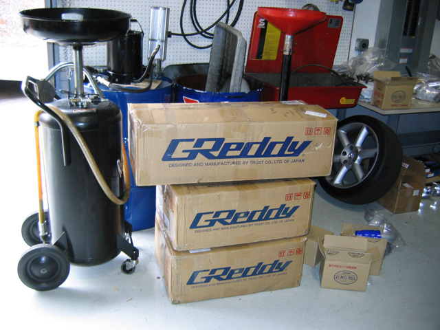

Old Mar 14, 2004 | 03:05 PM
Bini2's Avatar
Bini2
Posts: 798

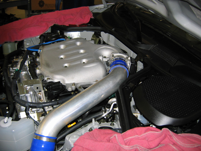

Pic2

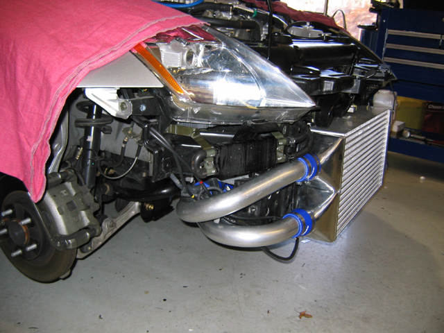

Pic3

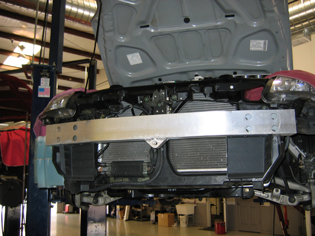

Last One for now, I promise....
Old Mar 14, 2004 | 04:28 PM
etx's Avatar
etx
Posts: 949
From: Detroit, The Motor City
Lookin good! Good choice.

Old Mar 14, 2004 | 07:25 PM
Apexi350z's Avatar
Apexi350z
Charter Member #50
Posts: 3,552
From: Houston, Texas
from the last pictures, looks like a big brake upgrade may be next
nice choice of FI.. can't wait for the final pics and result!

From: Upland, CA
No Brembos??? ACK! Get some REAL brakes on that thing before you go tearing down the highway at full boost! Any more pics by the way? Lookin' good so far!

Bini..two things.
I share your thoughts on the BOV...get it...
Second, make sure you mechanic uses safety wire to secure the heat shielding material to the engine harness and fuel lines. In your pics, I see zip ties....those will melt in about 3.5 seconds with those hot hot exhaust housings that close to them.
Good catch, email sent to my installer....thank you.

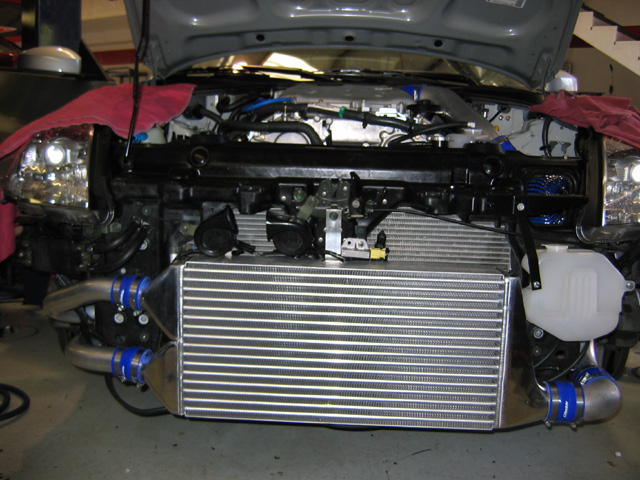

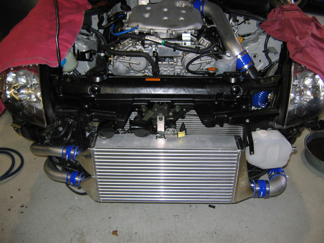

Updated Pics, SMILE!!
