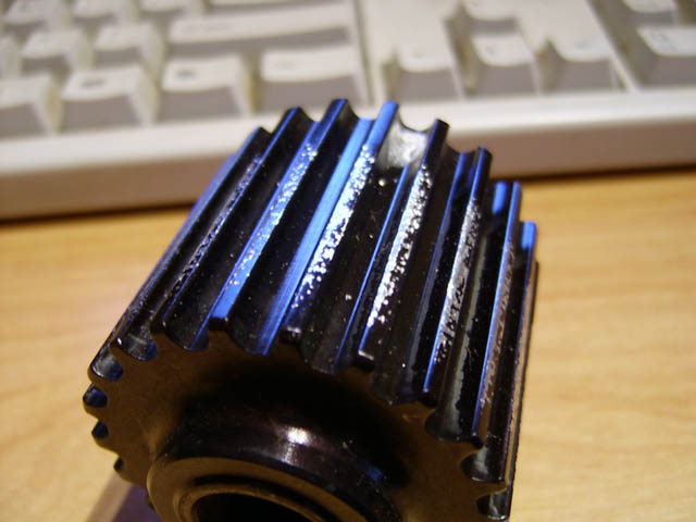

Max,

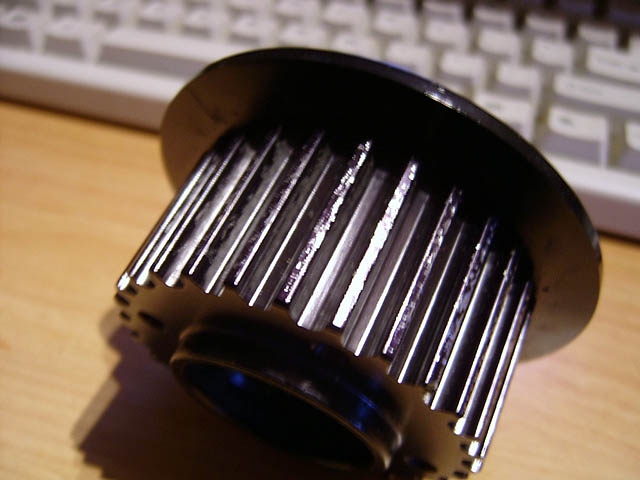

You and I appear to be the only one with the belt issues..Here are a few pics of my pulleys and belt from the rear of the blower..The first pic is the pulley on the rear of the eccentric tensioner and the second pic is the pulley on the rear of the blower...Are yours chewed up like this??Its amazing what a little rubber belt can do to metal...I think I may know what the problem is..There are washers with lips on them that seat into the pulleys when you install them,I noticed the washer on the rear of my blower pulley was a regular washer..This may or may not cause the cog pulleys to seat further down the shaft,throwing the alignment off...Theory??Maybee...I was under the impression that the washers were designed to seat into the pulleys so they would be centered and not look like they were off center when the pulley was spinning..But maybe they serve a purpose in stopping the pulley from seating too far down the shafts..

Here is the second pulley..I am replacing both of them just in case the wear is causing the belts to chew up at 60,000 rpms...

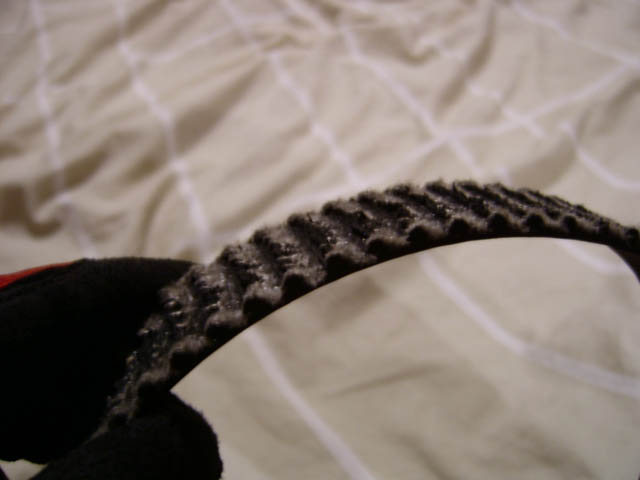

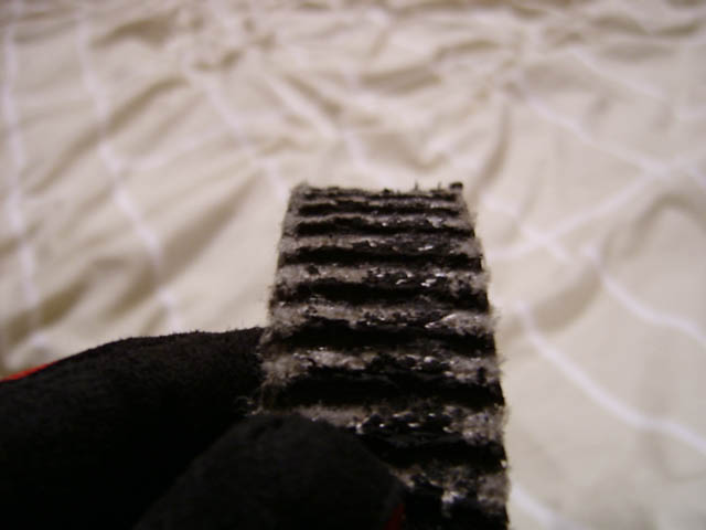

This is what is happening to my belts..Look familiar???The damage appears to be in the center of the belts...

My belts and pulleys were even worse than that.
The belt has fiberglass in in and the pulleys are aluminum, any misalignment or out of spect tension and the belts fiber glass will slowly eat away at the soft aluminum.
If this helps this is how I resolved my 3 belts tearing, I no longer have any belt issues so maybe it will help you too.
Serpantine belt the big long thi one. The Jack Shaft Pulley that the serpantine belt ran around was warped, it happened, stuff happens so I am not blaming anyone, too many people worked on my car. Maybe it came warped, maybe it wasn't tightened correctly after two installs but for whatever reason it was warped and cause the belt to run out of alignment costing me two bolts. Resolutiuon, new jack shaft pulley, runs true now, old pulley has obviuos signs of damage on back side that rubbed against the block area (big pulley) problem now solved 3 months no tears or wear.

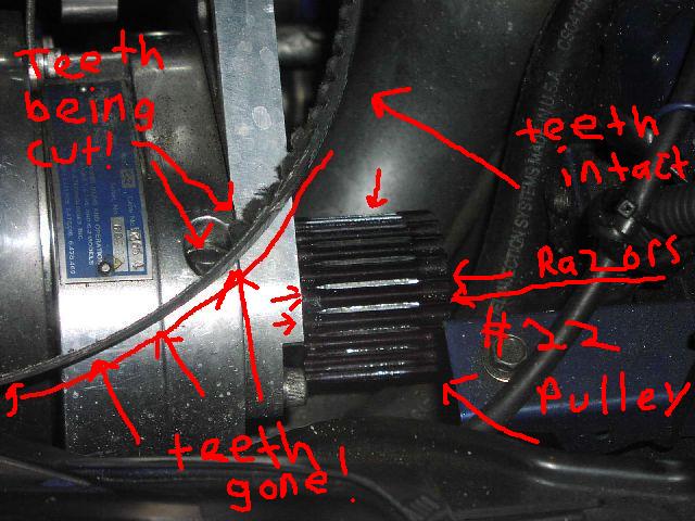

the left #22 is worse than what shows in this pig that silver areas are jaggedy from the fiberglass in the belt and snag and yank the teeth off. 50 dollar pulley for that little thing man!

Just noticed something important, your belt is wearing down the center mine was cutting from the top, if you look close you can see the teeth being sliced off on the top of the belt not worn in the middle like yours. Wierd.
