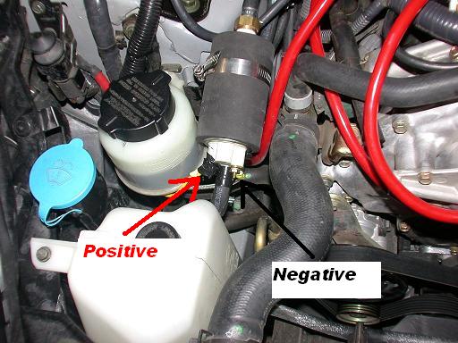

No, we didnt have a fuel pressure gauge handy. Right after the 2nd pull and the power was still way low, i suggested that maybe the aux fuel pump wasnt working but the tuner said it had to be if we where making max boost. I just said "oh ok," but it didnt make any sense. The tuner set the DFMU so that the A/F read 11.8 and we where making 20+ more rwph then stock, im willing to bet its because we didnt have enough fuel. The fuel lines are not kinked but do have a few loops. The ATI manual doest say which terminal on the fuel pump is positive or negative so i just followed the pic. This is what i have on mine. The fuel line is at the bottom and a blank space is on the top. The Positive terminal is on the left.

If you were making boost and the pump wasn't working you can kiss that motor goodby. Your a/f would be so high it would melt the cylinders. I would say way above 20. So I would venture to say its not the pump

Ok, I guess your right on the aux fuel pump working. 7lbs of boost is alot for a stock fuel pump, that eliminates that possibility, thanx.
