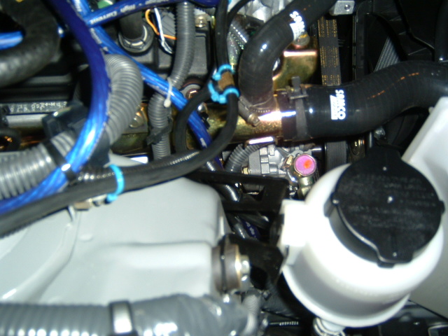

we (the installer and I) used all blue zip ties, CEPT for the new ones on the second BOV (wound up with a polished one, with a red hat, so we used red zipties, ......lol)
