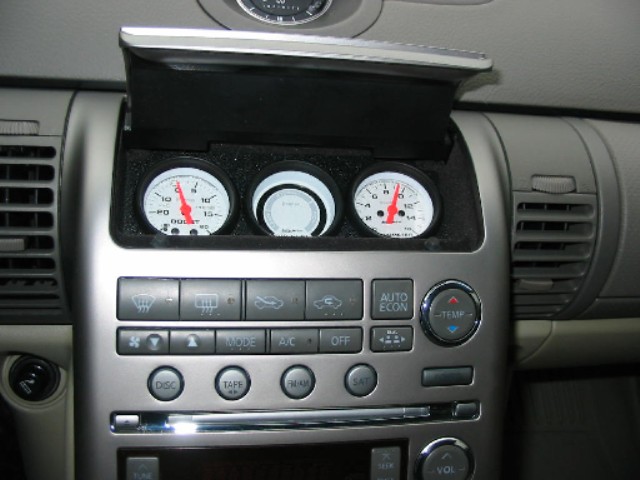

Do you have a picture of the 3 gauges in the empty cubby?
Chops

here you go

kznard.........you need to get rid of that $60.00 narrowband A/F meter and purchase yourself a AEM wideband A/F meter.........narrowband is useless.
Old Apr 27, 2004 | 06:15 PM
kzanard's Avatar
kzanard
Posts: 145
From: Boston area
Fluidz - I KNOW! AEM wideband are backordered so installer threw in the narrowband for now (useless other than cool looking lights for those who don't know!).
-Z-
