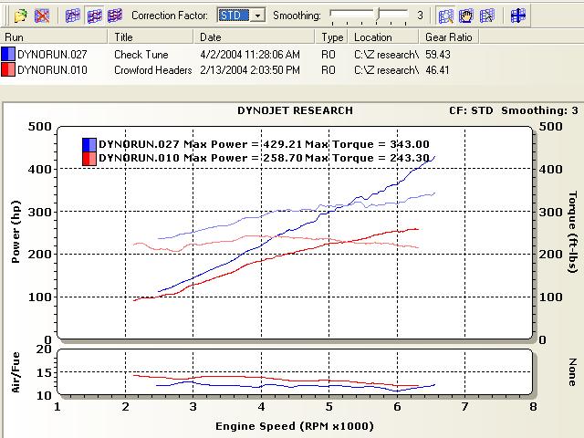

Vortech SC -- Is this dyno possible???
I saw this dyno sheet on another board. They claim that the car has a tuned Vortech SC with intercooler, Crawford headers, and cams (don't know brand). It says 429 rwhp. Hard to believe.
not too hard to believe... its not a turbo install, nor a stillen install.
if its a boosted 350, it is an ATI or Vortech kit. you can tell its a centrifugal S/C because of the low torque, and the lack of it until over 4500 rpm...
i like the hp number, but i get that max. torque number at 3600rpm

It is for real.

Yes, that is my dyno and no offense taken. Because it is a centrifugal SC, the low end torque isn't as pretty as a roots or TT. Still, I have found I can spin the wheels through 4th gear and part way through 5th with the power I have.... there's plenty of power for my use!
We are looking at trying a few tuning tricks to pick up a little more torque down low, but I mostly enjoy rolling launches so whether we get more or not, I'm happy.

One more thing... note that the graph you posted is STD corrected. The same data SAE corrected shows 419rwhp and I have another SAE graph (again same data, but different viewing software) that shows 424.9rwhp. So, I'm pretty sure on any given day I'm running between 410 and 430 actual rwhp.

It actually isn't hard to believe. Someone else put down 396 with just a crawford plenum, smooth tubes and a Borla exhaust. If you look at the graph, you can see a big surge in power at 5500 where the cams start to open it up. Below 5500 rpms, it looks like a regular Vortech car with bolt-ons. Above, the came really wake it up. There is actually still more power you could easily get out of the car by just raising the rev limiter since it has even hit the torque peak when it hits the limiter.
Good observations, Loren...
Is there anyway for me to raise the rev limiter without a full ECU reprogram? I don't want to change the ECU whole map, just maybe bump my rev limiter up to the 7000-7200rpm range.
