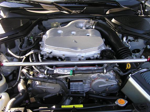

Does anyone know if the Crawford strut brace that goes with the original Crawford plenum, will fit with a Vortech SC and intercooler installed? Here is what the brace looks like:

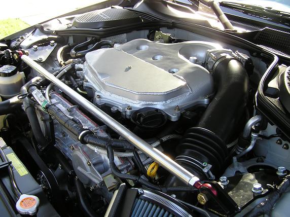

Default another view

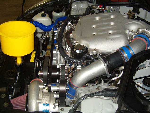

maybe, maybe not but i know that popchoker aint gonna work...........LOL
take a look and you can see if it will or will not

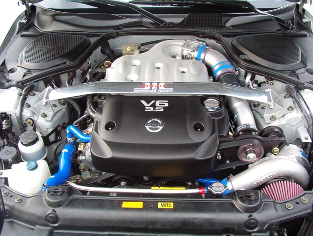

Old Apr 19, 2004 | 05:31 PM
fluidz's Avatar
fluidz
Posts: 794
From: Vortechville,CA

Default I'm not hopeful about the fit
Thanks, fluidz. It will be close, but my guess is the crawford brace won't fit with the vortech sc. Do you have a stock hood?
If so, I'm surprised that the JIC strut brace fits under it.
No... likely you will have 2-3mm of clearance between one of the toothed pulleys and the strut bar. As soon as you put the car into a curve (even a mild one) the body flexs enough to make the strut bar rub the gear.
I spoke to Doug at Crawford Z about fabricating a special bracket to move the strut bar back, but then there is a greater chance of it rubbing against the cam sensor housing and that would be worse!
Right now, we're planning (Doug and I) to take some measurements when we meet again at ZDayZ. It probably is going to require a custom fabricated bar, but if we come up with something maybe is something Crawford Z can offer to Vortech owners.

considering that the crawford brace does little or nothing since it is placed so far forward from your struts i'd get rid of that before the plenum.

Is it me.. or does that JIC Strut bar look like it can fit over the Crawford Plenum?
