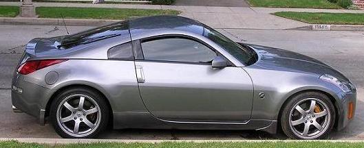

If I buy the Greddy TT kit, how much would you charge me to personally install it in my 350Z?
Attached Thumbnails Oh Dear..The Greddy TT syndrome is contagious!-350z-side-above-cropped.jpg
