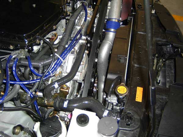

samco and nismo LT installed below..........
