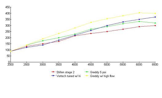

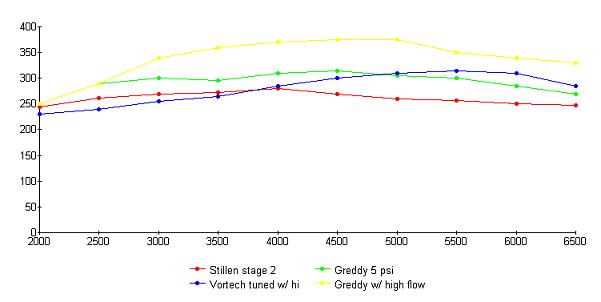

Here is a chart showing dynos of three different FI setups. Which you rather drive? As far as cost if you take the kit out the the box and bolt it on and never touch it again the supercharger is cheaper by about 1500.00. But how many people are really going to do that? take a close look at the 8psi Greddy and 8psi Vortech. They are a great example of what 80% of the FI crowd will end up with. It's a FI with high flow exhaust and tuning. About the limit for daily driven without gettng serious.
You guys with the "lag" kill me. the only thing that makes instant low down power is the roots but it can only flow so much on the top end. The other superchargers (centrifcal) have terrible low end look at the charts, below 4k they are not spinning fast enough to make real boost (ie more that 3psi) thus no low compared to the turbos.
