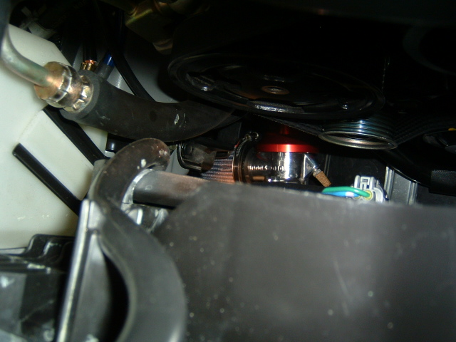

What is this BOV filter cap your talking about, can you show a pic
Old Jun 23, 2004 | 05:35 AM
esemes's Avatar
esemes
Posts: 660
From: clearh2o, FL
here it is, slightly modded

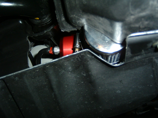

Old Jun 23, 2004 | 05:36 AM
esemes's Avatar
esemes
Posts: 660
From: clearh2o, FL
here it is, viewed from the RHS wheel-well......
