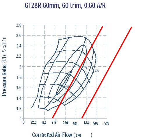

Since you are an experience turbo fabricator/installer/tuner I wanted to ask you a couple of questions regarding a single turbo option. I know every production turbo kit fabricator has said that the single turbo option was not really optimal because of the lack of space to put a "big enough" single turbo. Now my question is regarding the possiblilty of using one single "smaller sized" turbo like a GT28R that could still provide the 5-6psi of a "base" kit. Of course, there would be a more pronounced turbo lag and a fairly limited attainable peak power, but for someone who would plan to keep a "production" kit at those levels anyway, this may not be such a drawback. My biggest question however, has to do with the actual settup of a single turbo on our engine. With exhaust manifolds on opposite sides, would a single turbo settup consist of one stock exhaust manifold on one side (still dumping directly out the exhaust), and a single turbo manifold on the other side (basically only three exhaust ports drive the turbo), OR does the single turbo manifold still have to involve all six exhaust ports (in a wrap around the bottom of the engine style?). Obviously the biggest reason prices for TT settups are so high are the facts that you need 2 turbos,2 wastegates and 2 manifolds rather than just one of each (and these are the most expensive components aside from the IC).
If you could drive the turbo with a single-side-manifold, then technically one should be able to use all the measurements from existing kits for piping, as well as their manifold, and a single inlet IC to make a cheaper reliable kit.
Even if I am completely wrong, could you give us some of your thoughts/ideas on single turbo settups. Thanks.

actually a gt28r single would spool up helluva fast. but it would not work well on the topend. as far as your other questions ill let someone else chime in

here is a gt28r compressor map. The first line is the engine cfm demand @ 6500 rpms in a twin turbo application.
The second line is using the gt28r in a single turbo application.
You can see this turbo is in no way even close to big enough to use as a single!

I found a great site about a year ago has alot of great info and java calculators related to turbo applications. http://www.stealth316.com/2-turboguide.htm
When i need a compressor map i just search around on the net till i find it ... T-56 is too small probably a t-70 ill look for it.
