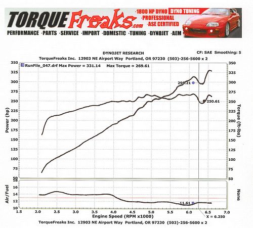

So last week i got my car dyno'd and came up with some interesting results.
Backround info: got the S/C installed in dec. and haven't had any problems. never tuned at install. right before i come up to oregon i noticed that i was kicking black smoke a little a thought that it might be time to change the plugs. got 1 step cooler NGKs and headed up to oregon. when i get here the S/C is making a much louder noise and a little whistle. the cog belt is fine and the sound seems to be comming from the S/C itself. The smoke that was little has turned heavy and under light throttle i get grey smoke and under WOT i get heavy black. so i get it tuned a recommened place in portland(4 hours away) and this is what i get. the first one is the one i ended up with and the second is what we tried to get when we pulled the timing.

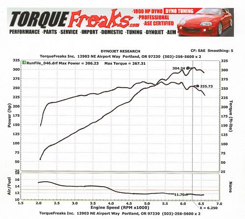

second

Why are the # so low? i don't get it? what might be causing the smoke and the louder noise. i haven't been able to get in touch with anyone at Vortech and at this point i don't know it i should be driving it. Forced, emmes, anyone can you help me? what should i think about doing from here. any kind of info would help

Assuming you are pulling timing, the A/F numbers look pretty darn good. However, the HP is WAAAAYYY low, so something is not right. Pardon the questions:
Where were you seeing the smoke (tailpipe, etc)?
Are you still seeing black smoke after tuning?
Could the sound you're hearing be belt squeal?
Do you smell rubber?
What are you seeing as far as boost psi?
--Steve

Dustin, those numbers arent too bad. Maybe on the next tuning session, you can ask them to hook up a pressure line and map your boost with your power and RPM numbers. My first guess would be to see if your boost was off, or the belt was slipping. Second thing I would look at is maybe ditching your stock cats...they could be holding you back.
You might also consider having them richen up your curve before 4000rpm....it seems a bit lean before that point.
Lastly, the tuner could have taken out too much timing, which would result in a significant power loss.

the top chart looks close to what the stock vortech SS will produce, on a very stock car....
aside from the oil problems, you need remapping, bigtime....
and YES, if the serp belt is loose, you'll see a noticeable HP loss (even if the peak boost is close to the factory 8 or 9 pounds..)

have you had the mapping done, cell-by-cell?
sorry to hear this; the kit is def. not working as it should
