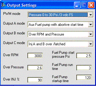

Default Output Settings
Is this how yours is set?

Yep, that's pretty much how I have mine set.

Its rpm OR preasure......not AND......right ?
Old Jul 31, 2004 | 11:40 AM
zimbo's Avatar
zimbo
Posts: 970
From: NC
I think the AND setting is better. No need for the pump to come on at 3000 rpms if the boost is 0.
--Steve
Old Jul 31, 2004 | 01:50 PM
teh215's Avatar
teh215
Posts: 5,753
From: Charlottesville, Virginia
--Steve
Agreed. Too much unneeded fuel could potentially cause the oil on the cylinder walls to break down and increase the friction between the rings and the cylinder walls. This would cause premature ring wear, blow-by and potentially increased oil consumption. I believe it is referred to as "fuel wash" ... my 2¢.
Old Jul 31, 2004 | 05:53 PM
booger's Avatar
booger
Posts: 10,500
From: council bluffs Ia.
The fuel preasure ...when the aux.pump is on...is at the FMU and your motor doesnt see that extra preasure . The FMU increases fuel preasure to the injectors as needed with boost . The only think about having the Aux pump coming on sooner is that its working [or on] when it not needed . Its not going to hurt your motor with extra fuel
