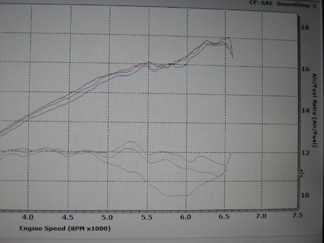

im pulling 2 up until about 4000, then it goes to 4 until 6000, then 6 until 8000. a pic is below.
im using the gates 93" belt. i might need to tighten it but my boost numbers are good, so it shouldnt be slip.
Attached Thumbnails if my A/F is perfect.....-dynonew.jpg

So near redline, is the total timing retard 6 degrees? If so, your timing should be pretty good. Just try to clean up that rich dip and smooth it out...you might pick up a few WHP.

yeah at redline the timing is -6, whats weird is that the dyno shuts off way early @ about 6500, i dont know why it does that, anyway,
the red and blue lines on the dyno were the first 2 runs, the green one is the third one where i added a little fuel to richen it up some, actually more than i wanted, and it didnt help at all on the hp dip.
you think i should pull some fuel instead of add it, would that help.
there was a guy at the dyno that mainly works on mustangs, who was watching my runs, he said the dip looks like the factory knock sensor is pulling some timing on its own, he told me to pull a little more, but i dont know if i trust him. although he was driving a new roush stage 3 with some nice engine work pushing out about 400hp at LOW boost (6.6psi and he was about to double it, damn it sounded good)

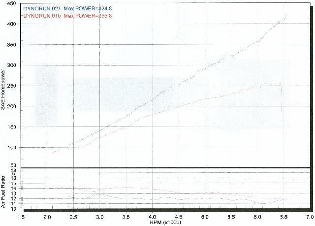

Just went back to look at my best dyno run... sorry for the poor image, this is from a scanned printout.
Still, you can see a very slight dip right before 5500rpm. I think this is the same thing tig488 is hitting, but as you can tell my dip is not as severe. I'm sure this is something you can adjust for if you keep working on it.

oops... forgot the graph...
Attached Thumbnails if my A/F is perfect.....-apr2_dyn.jpg

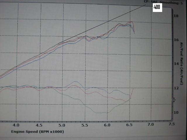

if things were linear, or even a little less than linear, i should be much higher, especially if it went up to 6800rpms, something is causing me to lose a lot of power, i need a good tuner.
damn mcduck thats awesome!

I do NOT think this is a tuning issue.
If you look at mcduck's N/A graph you'll see that it follows a pretty straight line. But that's only because he has LOTS of mods that give him upper end power. The typical N/A graph starts falling/leveling off above 5500 rpms.
If you had a Crawford plenum, aggressive cams, high flow cats, headers, and a free flow exhaust I'll bet your graph would more closely follow a straight line like his does.

I agree with Zimbo in part... my lack of high end drop off is mostly due to the Crawford Plenum and Nismo Cams... both of these items help free up intake breathing. Thus, easier to flow more air/fuel mix.
The part I still question is the dip itself. There must be some way to adjust the tuning from 5500 to 6250rpm so that instead of a dip, you have a smoother line running between those peaks. Otherwise, I think I would have the same, or a more pronounced, dip.
The question becomes, is it worth extra tuning time and cost to level out that dip. You won't be gaining a spectacular amount of power. Sure, you increase your area under the curve a little, but do you feel that dip in the powerband when you drive? Or does the car just feel like its pulling strong all the way to redline. If the car feels good, I wouldn't waste time trying to decipher the dip. If you feel a noticable (negative) change in the way the car pulls when you hit the dip range, I'd keep working on it.
