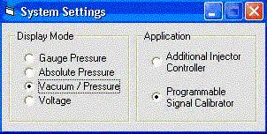

Be sure you have the R4 software settings correct. Under Options / System Settings you should have the following set.
It was set to boost gauge. Does this mean the entire tuning is set to that?

gspot35, changing the readout to vacuum/pressue does not actually change the map--it's a user preference you have to set the first time you run the software.
Also, it's NORMAL for the active RPM cell in the R4 software to be higher than the actual RPMs because the SS box rounds up. In other words, if you are tooling along at 2510 rpm the active row is the set of 3000 rpm cells.
