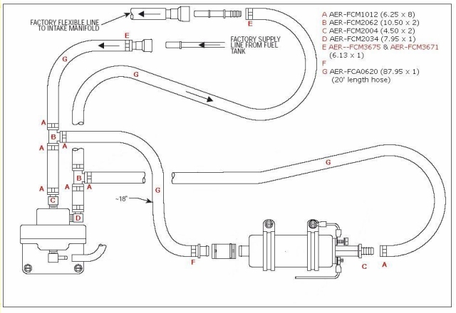

I priced out all of the fittings and hose that would be needed to replace all of the Vortech hoses with Aeroquip fittings and hose and it came in at about $270. If I have this problem again, I am going that route. Did you use the hose clamps that came with the Vortech kit?
If it’s not too much trouble could you post the needed parts from: AEROQUIP. I would love to get this out of the way before it happens to me.

Here is one of my preliminary charts using Summit part numbers which may or may not be correct. I cannot find the final one so, feel free to use this as a starting point ....
