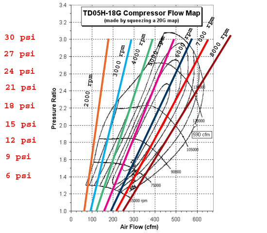

HMMMM. the compressor chart does suggest that the tdo5-18g turbos are not running out of air so it could be the problem lies elsewhere.
By my calculations 22 psi should see you @ roughly 675 rwhp (rough calculations probably not very accurate due to altitude))
However there again by the percentages based on what you actually made @ 18 psi vs what you actually made @ 22psi your numbers are spot on.
i put you @ 630 rwhp psi based on your 18 psi numbers as an exact equal percent increase and you actually made 616 so only off by 14 whp which could easily be a margin of error so actually these numbers may not be anything to be concerned about?
But then you go back to your dyno plot and have to wonder whats going on with the hp peak round 5k rpms....???
I just have to wonder about the plenum design when boosting this high. Crawford helps modify this design for more eaqual airflow however the overall factory design itself is still the same and i wonder if this might be the biggest bottleneck in the system(my guess)
I wonder how efficient the greddy plumbing design through the IC is at this boost level.
Have you considered a larger throttle body ??

oh BTW here is a compressor chart with engine demand lines i drew up a while back. The chart says there is still room in these turbos and that 22 psi should not be highly unefficient at all. (of course what actually is going on may be very different)
