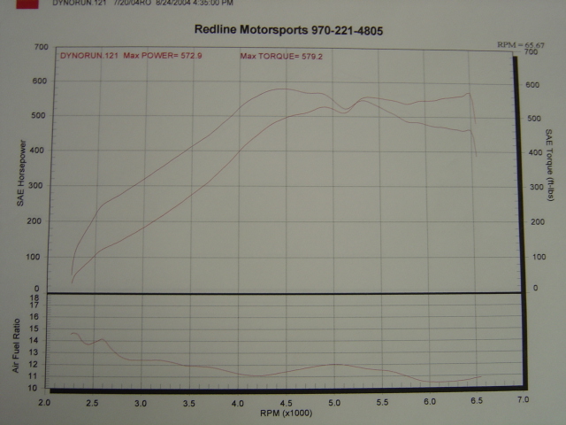

18 psi, 572.9 hp and 579.2 tq

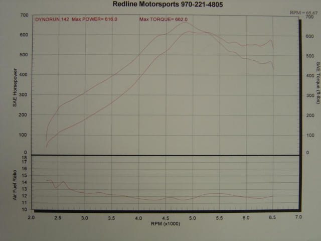

21-22 psi, 616.0 hp and 662.0 tq

Hrm, Looks like you need to open up the head a little more to keep you power from dropping off so soon. Those Greddy 18g turbos should be efficent up to 22 psi. 18 psi on a 16g is where it makes it's most power.

Head work..or timing. You have monstor torque.....i would check the timing first. Maybe we have reached the point where an upgraded cam shaft would help?? I cant recall if you swapped cams or did any headwork. Very interested though...keep us posted.
I will say your graph looks very similar to mine when I had too much timing retard. Monster trq numbers, but my HP peaked at 5500rpm and dropped off from there.
Can you verify that your boost was constant throughout the RPM band?

gq, we did hook up the obd11 their were no abrupt drops. timing is currently set a little behind stock. i would think this would be a fairly aggresive setting considering it started as na. we currently have 18 pound springs installed.what is strange to me is the difference in curves in the power and tq between the two boost levels. i am at a loss as to the lack of power at higher boost levels. i believe the turbos are at their max efficiency at around 19 pounds. i know this is contrary to the comp charts, but i am unsure of what else it could be at this point.any more ideas? i would hate to go through the trouble of turbos or a rebuild if it is unneeded. thanks for your help-jason
