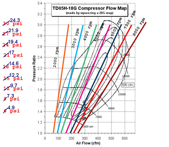

SQUILL,
Correct me if I'm wrong here, but there is a problem with your version of the compressor flow map. Since he's at 5200ft, you'll need to use ~12.152psi as atmospheric pressure. Your PSI(at the manifold) increments need to be adjusted upwards.
Originally posted by SQUILL
oh BTW here is a compressor chart with engine demand lines i drew up a while back. The chart says there is still room in these turbos and that 22 psi should not be highly unefficient at all. (of course what actually is going on may be very different)

Originally posted by IceY2K1Max
SQUILL,
yes you are correct i did not modify the chart for altitude. 2 bar on the chart would be double atmospheric pressure or 12.53 psi of positive boost !!! So boulder z you might want to consider boring out the compressor housing for a 20g comp wheel as your turbos are clearly running out of air @ 22 psi.... based on the chart if you were to run these turbos at 25 psi your gains would be negligable at best.

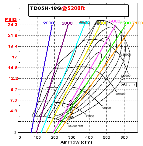

Also, what VE's are you using at those RPM? Also, what desity ratio are you using? 0.0730lb/ft^3 at MHI standard temp 76.3F and pressure 14.5025psi? In this case, I used 5200ft and 85-degrees to calculate the density ratio of 0.0603lb/ft^3.
He's only seeing a little over 12psi atomospheric pressure at 5200ft, so his turbo wheel speed is going to be much higher to make the same 24psi. Once you start approaching these higher wheel speeds the airflow dramatically drops off as you increase the RPM and efficiency suffers as bldrz dyno is showing.
I'm not sure what VE to use because of his cams, but using a 100% VE, I get this...

You could definitely improve your VE from 5000+ by tossing the single&dual chamber plenum design. After looking at these pics, you could do MUCH better by just fabricating your own single chamber short runner design.

Would you say you hit 24psi at 4700-4800rpm?
That dual surge tank piece in the lower manifold is KILLING your top-end. It needs to go. Your cams did help VE I'm sure, but someone needs to fabricate a single plenum lower to make one large single plenum intake manifold while looking OEM. Or you could just replace the whole thing with something easily fabricated like SpeedForce Racing did on this manifold($1100):
Personally, I'd take that route before tossing the 18Gs and going bigger.
