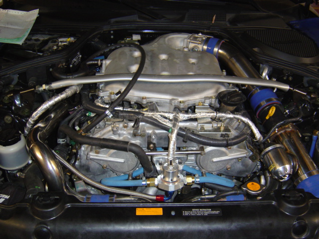

Hi all we are done with the hardware and here comes the e-manage. I'm having a problem with the MAF. I have the check engine light, slip and TCS or VDC and way after testing in turn out that MAF is not getting as required voltage.
E-manage wiring is good, all pin numbers are right when I opened the Airflow map it had no input all zeros. Should that be that way?
Could some one please send my a way how to, or if you would please send me an e-manage map to root@the-top.com or aalzuhair@aol.com
I’m running 7psi.
Thanks all,
Az

And by the way, we also tested two MAF sensors so the MAF itself is ok.
Az

might be a dumb idea...but make sure the MAF housing is facing the correct direction. There should be an arrrow on it to tell you which way the air should be flowing. Tony accidently put his in backwards, and he had all the simptoms you just described. Check it out!

The MAF is facing the correct direction in the posted picture...
GQ, on the Airflow map do you have any inputs or is it just blank (zeros all over)?
Thanks,
Az
PS: the first thing I checked was the direction of the MAF
