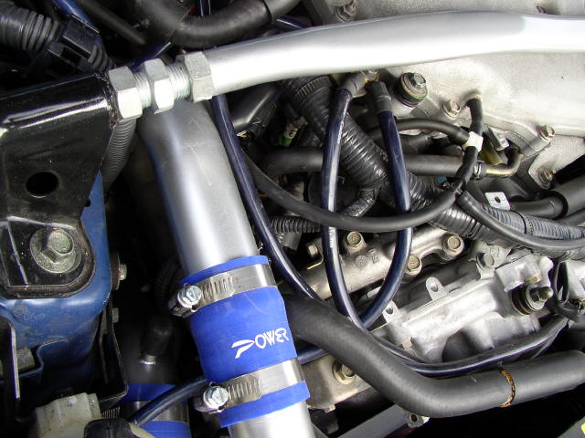

Okay, so I went to my mechanic who installed the PE kit with a print-out of this thread, and he couldn't understand what Gurgen was talking about.
The valve is not connected to the intake tube, as Gurgen mentioned was supposedly PE instructions, but is connected to the stock location.
The nipple on the intake tube has a rubber cap on it!
The installer and myself went through the original PE instructions and there isn't even a MENTION of how to connect these. Gurgen, maybe you could point out where in the instructions it says so? I couldn't find it.
Perhaps your installer made an assumption that it was supposed to be like that ? Sorry I don't mean to come off rude or anything, I just can't see it anywhere.
Anyway I took a picture of my engine bay (covers off), so you can see what I'm talking about. Is this the "final result" that you speak of ? If so, how could I still get oil sucked into the cylinders ?

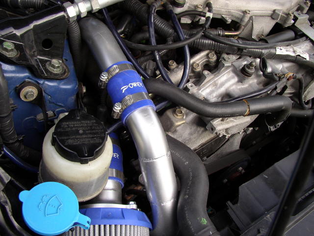

This is the way they were installed! My installer told me so because there were no specific instructions he could find to do otherwise.. so that's the way he put them on.

slay
That IS the correct way.... Mine was the other way around (the cap was on that tube sticking out from under the plenum.. to which your hose was connected.
And Slay.... the way mine was originally installed IS in teh instructions. Page 16, step 16.: "Install the genuine blowby hose to the suction pipe R-side. Cover up the surge tank side with the blind mask" This is a horrible translation. Generally, in these instructons: genuine=stock, surge tank has got to be the intake manifold, while the blind mask is, I'm sure, the rubber cap.
Step 17 describes the left side, which is assembled just like the stock car is.
Gurgen
