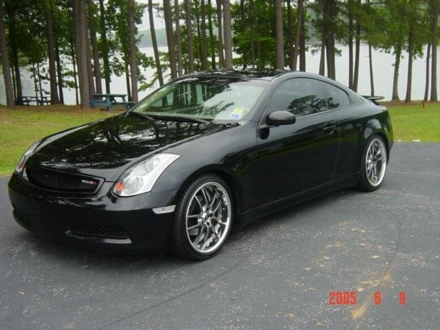

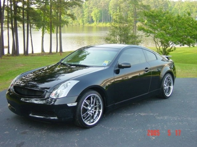

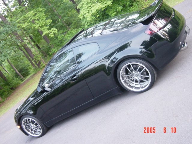

Here are some pics-The first one is "Before" all others are "After". Please let me know what you think.
Attached Thumbnails Dropped my G~Hotchkis/Kinetix/SPC-lakeside-g-before-lower.jpg   Dropped my G~Hotchkis/Kinetix/SPC-lakeside-g-lowered.jpg   Dropped my G~Hotchkis/Kinetix/SPC-picture-003.jpg   Dropped my G~Hotchkis/Kinetix/SPC-picture-004.jpg   Dropped my G~Hotchkis/Kinetix/SPC-picture-008.jpg

nice!
i'm thinking that the 1st and 2nd pic is reversd though

Originally Posted by illZ
nice!
Your right! Good catch!

Could you post a bigger side shot por favor?

Looks great! It's more of a visual drop than I would've expected w/those Hotchkis springs. What would you say the finger gap is in the front/rear now?
