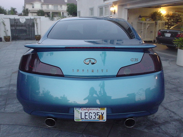

Just put the tailights and front turn signals on my Carribbean Blue. It took an hour, a hair dryer, a credit card, terry cotton towel, my brother, and patience. It came out really well. Make sure you get heat on the edges so that it wraps around the lamps. The blow dryer was more than sufficient. Also have someone help you. My brother worked the blow dryer, while I worked out the bubbles and the edges. Overall, I'm very happy with the results. I almost payed someone to do this, but it was easy enough for my brother and I to do. BTW use PLENTY of soap/water to lubricate the lamps so that you can position the overlay. If it gets dry, the overlay will stick, if that happens, jus spray some more of the soap/water solution on the vinyl to allow it to move again for repositioning. Thanks Andrew for this fine product!

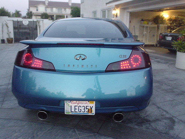

Lights on

oh man, that turned out really nice! Be sure to post some pics in the sunlight, I'm sure that blue is gorgeous.

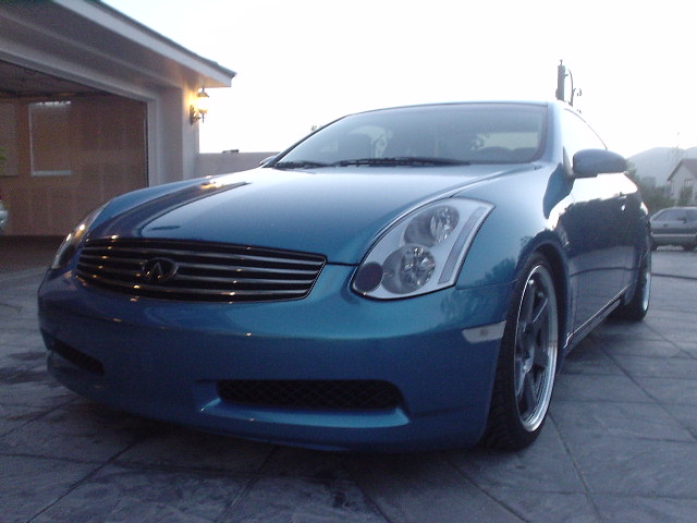

Front turn signal. Subtle yet noticeable.
