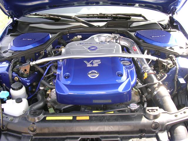

You may also need to adjust the strut bar to avoid any vibration & rubbing. The spacers I used were 1/2 the thickness of what came w/ the V4 plenum. Use 2 clay ***** on top of the highest point of the plenum & cover. Close the hood to test if you have enough clearance.
who painted your plenum??

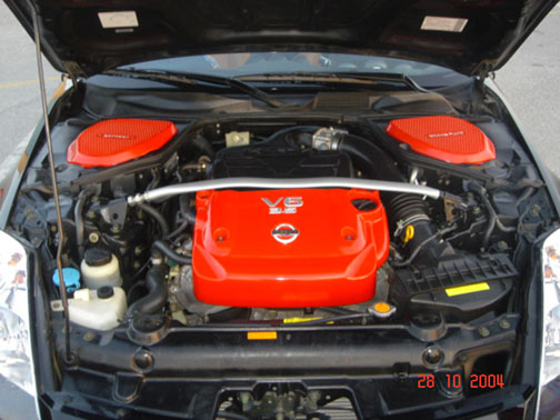

I attached the cover with the front screws only

who painted your plenum?? [/QUOTE]
I sanded, primed & painted the Kinetix plenum w/ Plasticote Engine enamel high-heat paint (500 degrees). Bought them in Pep Boys. The Engine cover was painted by Gundam02.
