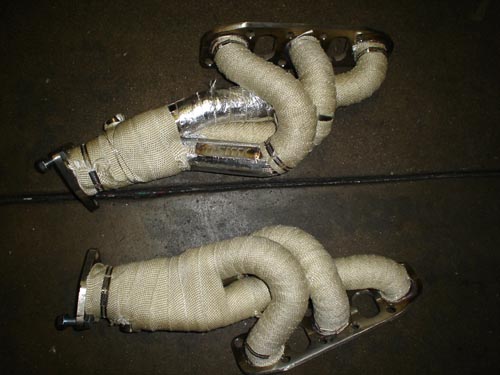

I heat wrapped my Nismos.

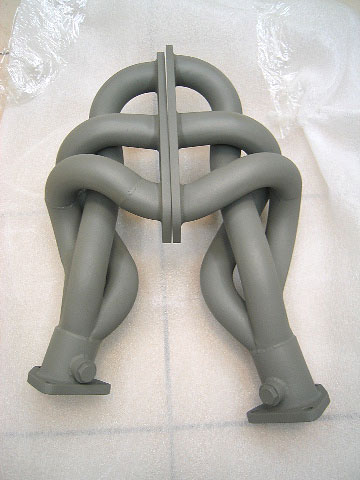

Jet-Hot 2k coated my TopSpeeds...they still run hotter than stock as told by my fan kicking on high sooner than usual, but the cooling system is more than up to the task. The other good thing about the coating is it runs inside and out so you don't get the destructive side-effects of wrap.
I did some research on Google and found instances of the Sterling finish failing after some miles so you might want to spend the extra $20 for piece of mind of the 2K coating. They warranty the Sterling finish, but who wants to install headers twice?
All told, not sure I'd do the mod again. Even with the group buy price, discount on the coating and reasonable install, it's not a lot of bang for the buck. I'm hoping after I get my catback and plenum spacer installed dividends will be paid...

How has the wrap worked out for you and how long have you had them.
...If there are no long term reliability issues, wrapping is the ideal solution.

Had them on for a while now, dont remember how long...at least for 6000 miles. No problem. Kept the heat down pretty well. But after the wrapping, it takes a couple of days to burn off the coating on the wrap tho...it will stink for a week or so.
