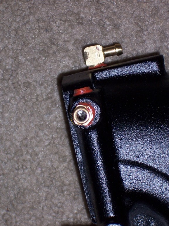

I installed my Crawford Plenum I purchased from Performance Nissan yesterday and after backing out of my driveway I noticed drip marks everywhere. After further inspection my buddy and I determined it was from one of the fittings and thought it just needed to be tightened. Tried that, with new hose clamps and had the same problem. Once we took the entire plenum off we could see a hairline crack. It looks like after the plenum was cast, it was threaded off-center. Once the fitting was added, the mounting boss cracked. See the pics. Its hard to see. The first is it off-center and the second is marked where the crack is. The length off the crack is about 3/4".
Anyone else have that problem? Should I contact Performance Nissan or go right to Crawford?

Hairline crack, tough to see. I would call Doug at Crawford directly, I'm sure he'll replace it. Phone Number is (615) 327-4159.

Question Viewing..
Hey,
is the fitting area where the wrench is positioned stripped a bit?
Looks like the edges are kinda of stripped...

No problems with the threading.
I talked to Doug at Crawford yesterday. They are sending me out a new intake today. They say the problem is due to shipping and handling issues.

To our best knowledge this is a packing and or shipping issue. The way the fitting locations are tapped and installed, it is almost impossible to split like above. I have seen the same fitting fall out of one of the returned stock cores we got back (in much the same way) when we had core exchanges.
Its just one of those things that happens.

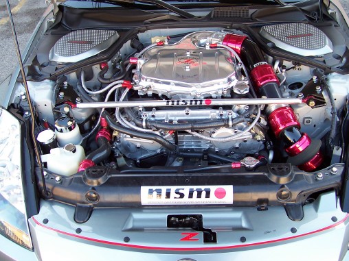

Hey pinhead .....the crack was on a newer cast plenum, not the V.5 as you mentioned. Have never heard of a v.1 - v.5 cracking for any reason...in fact, this is the first cast plenum that has been reported cracked (as far as I've read) & being that it was noticed as soon as it was installed and the crack was around a fitting it easy to believe it was either cracked during shipping or was missed in its final inspection, not from usage or normal install. Also, I seriously doubt that there have been more Kinetix plenums sold than the Crawford plenum - would have to check on that.
And BTW, I have used both plenums - Crawford v.5 & Kinetix v.4 - so have tried both......and know both. BTW, I have a never-installed painted Kinetix v.3 I'll sell ya cheap........Here's a pic of it along with the "fugly" Crawford I run
Attached Thumbnails My Crawford Plenum is Cracked!!-kinetix1.jpg   My Crawford Plenum is Cracked!!-full_bay.jpg
