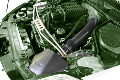

as for their so called cai...here is the low down on this intake. the filter is cone shaped with a huge aluminum ring used for mounting (talk about heatsoak). the rest of the intake is a black plastic shroud that covers the top of the filter and then its just open at the bottom.
imo, would have been better if they fully enclosed the filter and sucked the air from the front of the car like the k&n...then you could say cai. the system sucks air from the stock inlet and the bottom of the engine bay...where all the HOT air is.
going to wait and see how the new injen CAI (yes stillen, now this is a cai) turns out....looks promising

Sorry to hear that RoadWarrior... I too was fooled! From the image, it looks as if it's sealed all the way around, kinda like mine...
I know you're pretty handy. You should go to PepBoys, buy a APR's or K&N's newer/bigger conical filter and the adapter plate and just "rig" up something like mine. I've been really happy with it!

Technically the stillen intake is CAI.
Technically the Z has a stock CAI.
The vent in the firewall (or frame, or whatever you call it) allows the stock intake, or stillen, or popcharger, or whatever..suck in cold air from the bumper..not the engine bay.
True...this is not TRUE CAI which places the filter outside the engine bay to suck in the cold air...but TECHNICALLY the stillen is CAI.
So, in truth you're lucky they even let you return it, but for good customer service, once you explained that it wasn't what you thought it was, they should have let you return it without the restocking charge.
I'm not saying you were wrong, because I agree that you were just mislead, but on paper....that intake is a CAI.

i think a fully enclosed conicle filter that draws air from the front of the car is a good concept...similar to the k&n but instead have a sealed airbox containing the filter.
i am thinking of having a two piece air box made (a little larger than stock) with a conicle k&n filter mounted inside the box....then run 3" tubing to the front air damn (i already did this myself).
i had the factory inlet piece that goes to the airbox modified...goes from the stock square shape to 3" tubing. i then attached two pieces of 3" and ran them down and mounted them to the front bumber. thus, i am drawing colder air from the front air dam and away from any engine bay heat.
i will take some pics next time i have the bumper off....seems to work pretty well in combination with a k&n drop in filter and the stock air box for now.
you should have your setup dynod just to see what that intake is producing....i bet you get much more suction with the enclosed conicle filter and the reduction of heat soak.

however, i disagree on the stock cai because there is still a chance that air from the engine bay can get to the stock inlet. if they sealed off the intake inlet from the rest of the engine bay then i could agree....such as something similar to the cooling plates being sold on the market. even these cooling plates have room for improvement....i nice tight fit sealing everything off from the engine bay and sealed to the intake inlet as well. then, you would only be drawing air from soley from in front of the car.
the cai is a good topic for debate....but there is definately no doubt on the poor customer service from stillen

the stock imo is not a cai.....look at the design. it does not appear as a cia and uses an airbox. are they calling intakes with airboxes cai's these days? look at the design of the k&n...its a combo of an airbox and a cai because of the location of the inlet.

And to one of the posts above...I thought the stock airbox was a sealed unit. When I took it out of my car I had to finagle it off the duct that goes through the frame. That sealed the front and then the back goes right into the MAF. Where is it open to the engine bay?
the stock is cai, hence "cold air intake". It's not sucking air from the engine bay, but from the front of the car.. it's the best intake, and if it's not broken, don't replace it
you can drop in a k&n filter though.. that's what I have and it has been working great!

CAI is cold air intake. It doesn't include a provision for no airbox. Hell, if you wanted to make an airbox behind the bumper for the nismo or injen CAI's you could, that way it sucks less turbulent air. It would still be a CAI. It just refers to sucking in cold air from the outside of the car or hot air from the engine bay.
the opening i thought would be over the radiator....but as someone mentioned above this too is sealed when the hood is down. although there is room for improvement imo....like an effective sealing plate in front to keep that cold air in front of the car. autoteknic is the only one i have seen that really does a nice job of sealing off the entire section but the area where the inlet comes in is too small for us z's and is made for the japan model which has a smaller inlet.
i have the k&n drop in filter right now and i am very happy with it and the stock intake for now.
the new injen cai does look very promising....i am really going to take a good look at this intake....it appears better performance wise than any other cai's that are on the market and with really good dyno numbers.
