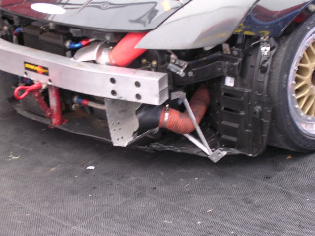

All I can add is that both current 350Z race cars(Schuitemaker and Performance/Unitech) in Grand-Am Cup use the Injen intakes. They use whatever gives the best gains. They have no stake in intakes other than what is the best. This speaks volumes to me.

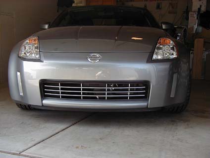

I combined my jwt pop ch. with the injen intake so that the jwt would be down in the front grill to get the cold air that breeds more power.
have not done any dyno's yet but I like the combo VERY MUCH!
see it down in the grill?

I forget which track they were initially testing on, I think Mid-Ohio. He said that they were a few seconds faster with the intake and that it equated to a few miles per hour faster on the straights. There is a difference between dyno and track. I would tend to trust track results when a very well funded race team is doing the testing and their goal is a faster car.

injen pic
