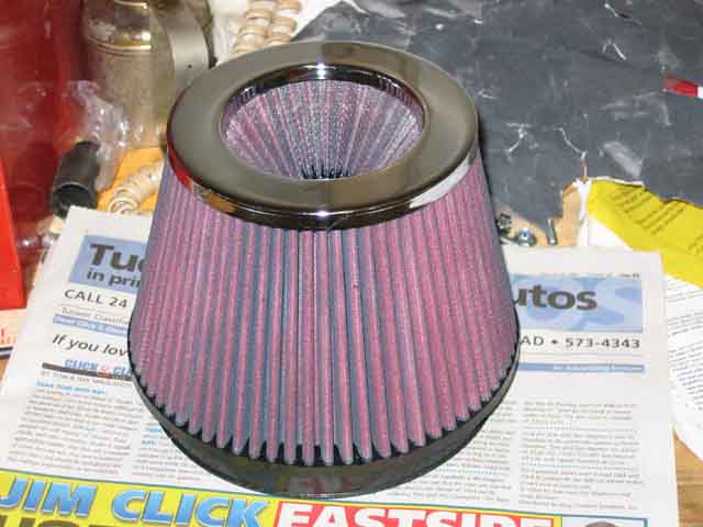

Use the K&N cleaning kit, let it sit, then hose it from the inside out. Let it dry in the sun, then reoil and let sit overnight. Rather than use the spray, I like the liquid that you apply to each pleat.
Lou

That's not blue you're seeing, it just shadows. There was no blue left on it when I applied the K&N oil. I took great pains not to overoil.
BTW, I would never spray from the outside in. The dirt that the filter traps is on the outside of the filter, and you want to get it out. If you spray from the outside in you will just force that dirt deeper into the filter.
