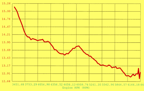

Is that across the board? Here is the AFR from my stock pull using a tailpipe sniffer...btw, are these horribly innaccurate compared to a wideband? Is WB what most dynos use?
Attached Thumbnails Would I need a tune after I/H/E and plenum?-020505_afr.gif
These are just as accurate imo as a wideband. Your mods have made you a little lean down low and mid range and you get richer as rpm's rise. I think you would be a good candidate for an ecu reflash or a piggy back tuned. I had over 15:1 lean A/F's before I even did the flash, but Im glad I did, all the mods really came together. Dyno's use widebands but they usually measure through the tail-pipe aka sniffer. Some places put the wideband right into an exhaust bung, but you usually see that more in high hp FI applications.
BTW-what kind of dyno was that?
That was a Mustang dyno...but I think you misunderstood my post. That was my stock (before) AFR. I don't have my "after" to post yet...I did the after pull, but the printer was broken.
Oh ic. I would question there 02 sensor then because I have never seen a stock Z that lean. I would go to a different dyno and double check things now.
