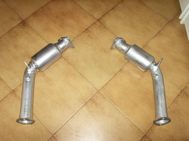

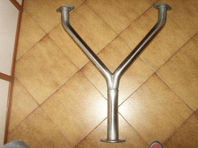

coming home today!
Attached Thumbnails Craftmade Resonated Test Pipes & Y-pict0002.jpg   Craftmade Resonated Test Pipes & Y-pict0003.jpg

looks like those bends weren't mandrel......at least on the test pipes. right after the resonator on the long side you can see the ribs. Not excellent for flow.
hope they're not raspy!

Ehm i'm not all understand.. but i hope it's not a big problem!!
Rasp..no i hope!!

Yes installed all!!
So long work but good result!!
More exotic sound, so smell and so rasp between 2000 and 2500 but good...

No mesh bends? U might break something

enlighten me why the mesh bends are so important?
why would something break

...... ...WHAT!?!
Mesh bends!?!?
BRAKE!?!?what brake...
Can you explain me in easy english
THANKS!!

coz you dun have your "Mess Ben" in your Y pipe,
such that when your engine "Talk", i.e. when you give her some gas,
you will be adding "Low" onto your exhaust system, such that there
might be a chance that you are going to "BRAKE" your exhaust manifold aka Header.
In simple english, since you don't have "Flex joint", when your engine is under load, the engine will move, and hence put alot of load onto your exhaust system... which may crack something down the piping....
good luck
P.S. btw, some catback designer doesn't think the flex joints are that important, i.e. Stillen and some big JDM manufacturers manufacture Y/X pipe without any flex joints

so you think that cause my Y are all directly without "silencer",cat lower cell, on original exhaust,mean more gas power out and can brake the original part..uh..that it's not good.
But infact, i have see different product without "silencer", but maybe for a complete exhaust.
Ok i need to change it!
