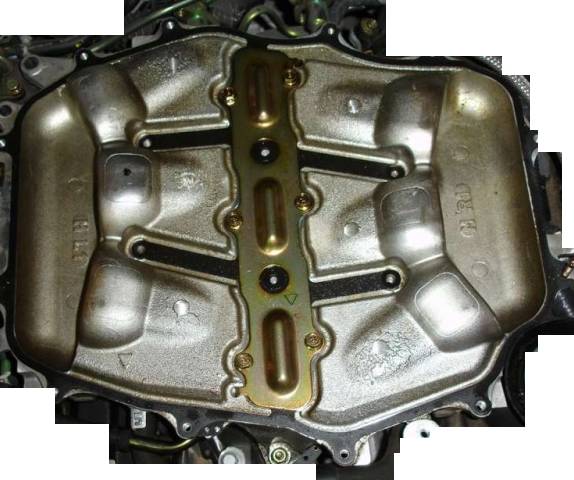

Take a good look at our lower stock plenum. Those slits that take air to the cylinders can't be efficient. And the space before the "runners" (can I call them like that) is just ridiculous. That's basically my beef against the spacers and top-half replacement plenums, they don't improve that part of the plenum. No wonder Nissan made significant changes to the lower plenum on the new RevUp engine.
Nissan changed the way air enters the motor through the lower plenum. On the newer version, this lower plenum has more airspace in front of the runners, which have been shortened significantly. This combined with a more "dished" inner surface allows for more air volume in the plenum chamber, drastically changing the dynamics of how the engine gets its air. The change in design is largely the cause for the difference in power and the different styled power bands between the two versions of the VQ35 engine.
