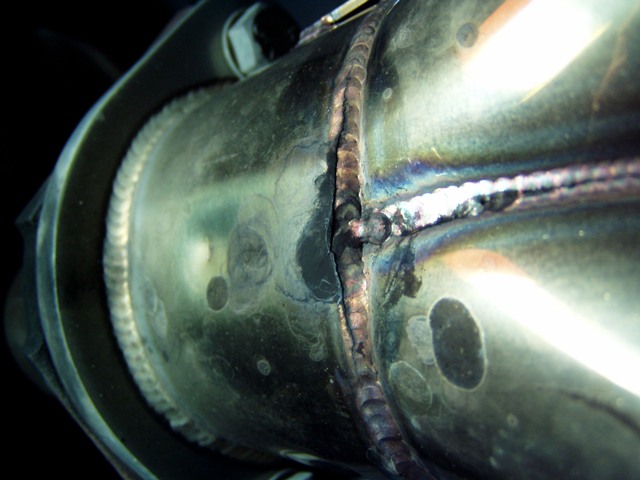

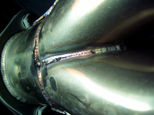

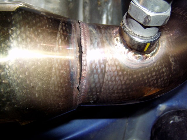

I have noticed i have been getting louder for a week or two, so i finally got time to look under the vehicle.
I put on Test Pipes from Tuningpros.com (Megan, pretty sure) and all hell has broke loose.
My Gruppe Y-Pipe is cracked, my B-Pipe is cracked and the test pipes are cracked.
You think the test pipes could have caused all this?
This sucks bad!
Attached Thumbnails OMG !!!! Look at this crap!!!-gruppe-1.jpg   OMG !!!! Look at this crap!!!-gruppe.jpg   OMG !!!! Look at this crap!!!-stock-b1.jpg   OMG !!!! Look at this crap!!!-stock-b.jpg   OMG !!!! Look at this crap!!!-test1.jpg

My gruppe-s y-pipe cracked, probably from me dragging my low *** car over speed bumps and driveways(damn long wheelbase).

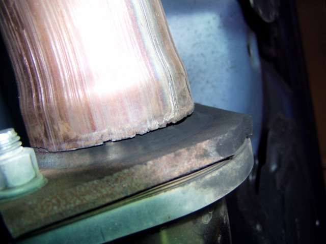

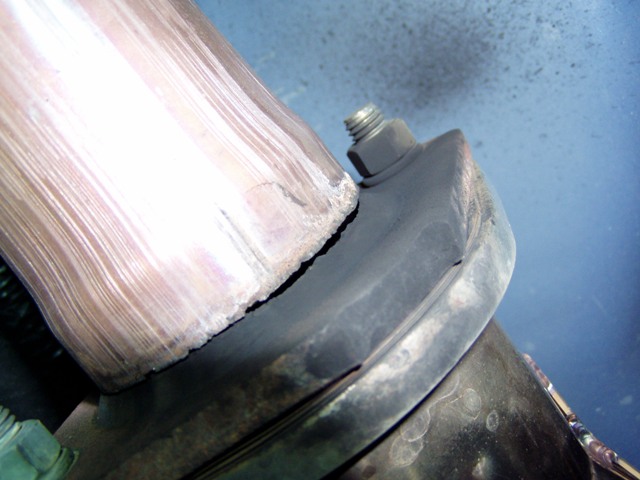

I just took the whole thing off. Y-pipe, B-pipe and tests. There is something rattling inside the Test pipes. In between the mesh and the cover. That was a BIG annoyance!!! That incessant rattling. The B-pipe is almost cracked all the way around. The Y-pipe is cracked just a tiny bit. The driver side test pipe has almost come all the way apart.

Do the test pipes use or delete the OEM hangers?

did u take the brace out when you installed your test pipes?

the megan's do not use the OEM converter bracket

Yup, they have no hanger bracket.

i had the same ypipe and it cracked in the same exact place. i ended up getting a name brand ypipe (JIC) and have not had any issues.
but in your situation that is a lot of cracks.... maybe the combo of your engine brace and the quality of megan and the gruppe-s stuff has something to do with it?

I don't know. It beats anything i've seen.
I think it has to do with having no bracket mounts.

My Gruppe-s y-pipe cracked same spot after one season, stock cats. Guess you get what you pay for....

Thanks. I doubt that it matters. Test pipes are light. The probability of test pipes stressing the entire exhaust system is slim.
