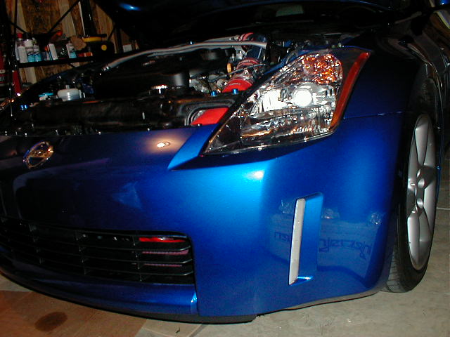

and a pics of the clear corners
Thanks to bhobson333 and the 2 guys from the local Z club for the help

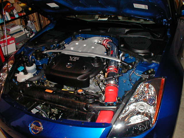

Old Jan 20, 2003 | 06:57 AM
Eric1h's Avatar
Eric1h
Posts: 678
From: NC-Raleigh area
Old Jan 20, 2003 | 07:35 AM

WOW..that looks really good...
Old Jan 20, 2003 | 08:08 AM
2k3silver350z's Avatar
2k3silver350z
Posts: 479
From: knoxintheville
for those of you who are worried about hydrolock i see the perfect spot for a bypass valve. the 2nd piece of tubing from the top could be take out and replaced by it. just FYI
