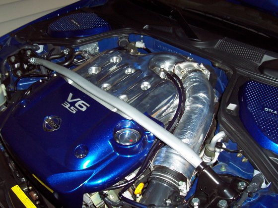

I have the Thermo-tec Cool Tube intake heat shield, the one you have pictured, wrapped around my intake tube. It's more for looks than functionality because I figured that the amount of time the air spends going up the tube is less than ½ second so it isn't going to heat up much. Every little bit helps, but it will be minimal.
You'll see better results from the Motordyne Isothermal gasket and the TB heater bypass. I did some temperature measurements of my upper plenum before and after and it runs about 30ºF cooler. Considering that the air flows through the plenum slower than the intake tube, it has a better chance of heating there. Do you have the Throttle Body heater bypass installed?
I have an OBDII monitor that I run in my car and did some temperature measurements similar to yours. At highway speeds, the air temperature at the MAF sensor is only about 5ºF higher than the ambient temperature. Not bad for the stock intake. That's probably why a CAI doesn't really show big gains on the Z.
