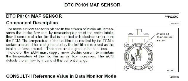

Odd. The shop manual says otherwise.

thats what i saw in the manual!
eh. oh well. :P
