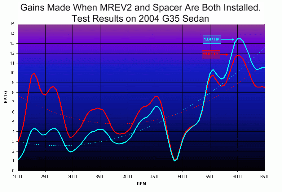

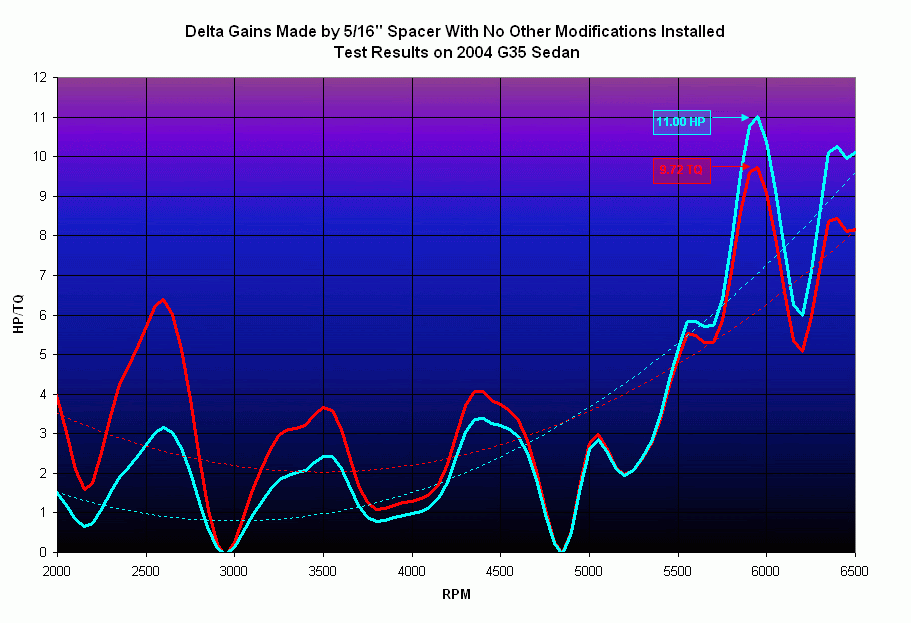

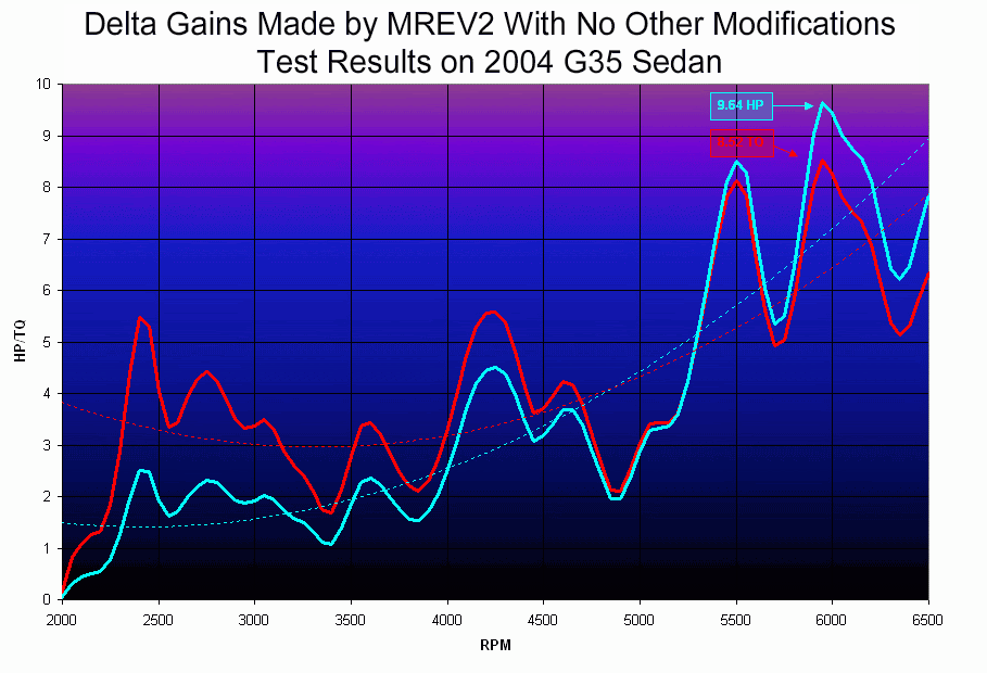

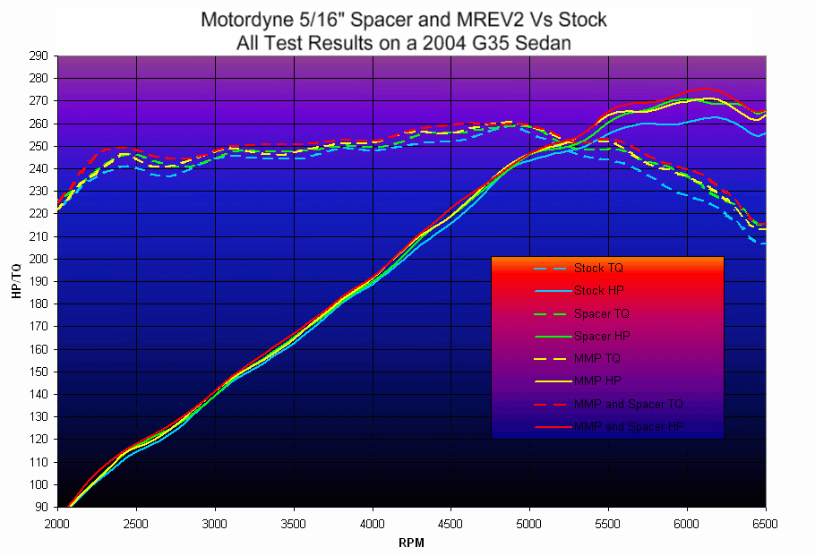

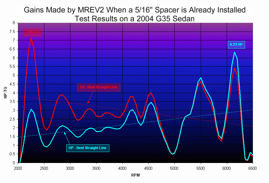

Here's a few delta plots on the non-revup.
Below is a comparison of Stock Vs Spacer Vs MREV2 Vs Spacer with MREV2. All of this testing was performed on a 2004 G35 Sedan with the non-revup engine.

Thank you Tony for putting in the work to show the deltas, they are by far (to me at least) the most useful stat for people looking at bolt-ons.
They also really highlight *Real World* results, i've grown tired of seeing "oh it only gives this much HP/TQ"
The few times i might go and race my car, that's great, but i want power and torque i can use every day, not only do the Motordyne products give real world usable gains, but these delta graphs really highlight that fact.

Thank you!
The analysis and plots are mandatory whenever a dyno is done. Its shows exactly what the change in performance is without the baseline obscuring the background.
I did tons of this kind of stuff when I worked Kaiser Marquardt and Boeing Satellite Systems propulsion division. Designing rocket engines, testing the prototypes, blowing some up, taking all the high speed data and doing serious analysis. In flight data analysis is even more data intensive.
So doing an A-B analysis is very easy and effective. It makes the delta clear and easy to see. It should be an industry standard in addition to full dyno plots.
