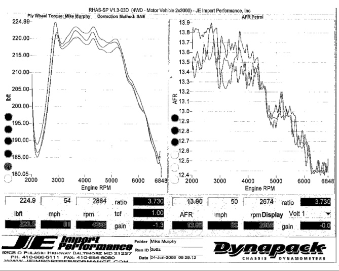

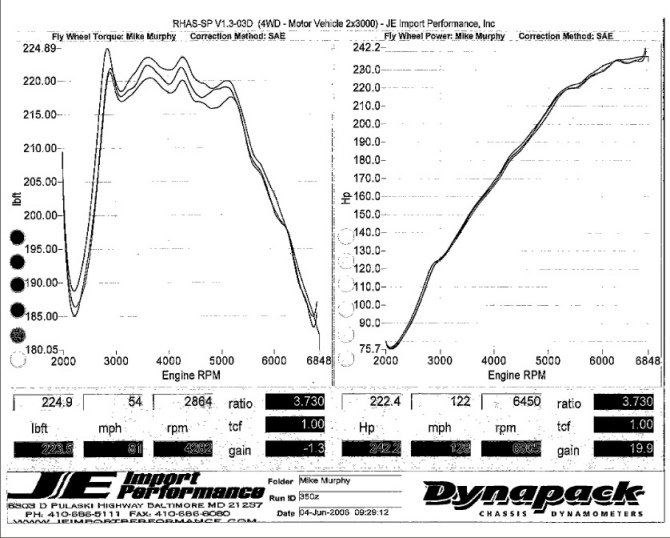

Default The Dyno Numbers are in!
242 HP / 224 Torque
I won't be able to post the graphs until tomorrow but, you will be surprised at what you see........
The air/fuel ratio was great, mid to low 13's up to about 4700 RPM's then to the high 12's from 5600 and works it's way down to about 12.4
My RPM's are a rock solid climb. There was another Z that dyno'ed right after I did, his graph was completly different. We matched a lot of our cars part for part the differences were, My lower plenum, Sun Hyper System, stock exhaust. His car had a Top Speed Exhaust and Strup headers, different Y pipe, but it was aftermarket and Pullies. He pulled 266...I forget his torque # but, I will ask him. Now I have the shop pricing out a header install.....
5th gear pull, 3.73 ratio, yes we realized later it was slightly off but the other Z like mine ran about the same with a ratio in the 4's as when they corrected it.

Default Dyno Graph
Feedback is welcome, this was my first time on a dyno. Hearders are the next thing I'm looking at doing.

If anyone knows how to rotate the graphs and post them on the thread as a pic, it would be appraicated.

Here your go.
Attached Thumbnails Upper and Lower Plenum Porting with Dyno-dp1.jpg   Upper and Lower Plenum Porting with Dyno-dp2.jpg

Looking at your dyno and your A/F ratio, with your mods it looks like your car makes more power around 13.8 a/f from 3000rpm to 4000rpm then from 4000 to 5000 around 13.5 a/f and from 5000 to 6000 13.0 a/f then from 6000 to 7000 i would have it set at 12.5 a/f.
I think you would be very suprised with your car if you had it tuned.
