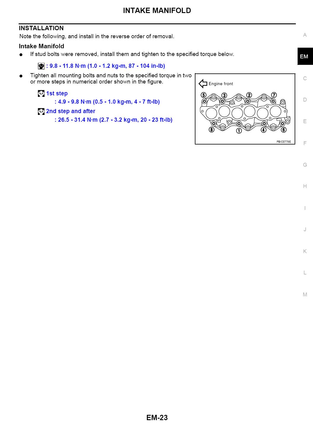

alread port and polished the plenum, but how the hell do i take off the intake manifold? the fuel injectors are attached and idk how to take the things off. is there a DIY on the removal? thanks

i'm not talking about the lower plenum, i'm talking about the manifold that below the plenum. i'm afraid that if i just start removing bolts then i'll not know what i did or how to put it back.
plus i don't know what i should torque it back down too. anyone?

He was talking about the Intake Manifold instead of the plenum set
Old Jun 3, 2006 | 01:31 PM
ATL_Red_G35's Avatar
ATL_Red_G35
Joined: Feb 2006
Posts: 589
From: ATL
here you go, have fun. Post the results once you're done

Ahh! thank you! where the hell did u find this??

actually could i explain to me what the "stud bolts" are? and does anyone know about the torque rates for the fuel injectors. (i got the thing off just fine, and only dropped 1 bolt (not into the cylinders) DAMN!!)

thank you. but that seems like a lot just the fuel injectors, since everything else isn't that much. plus the fuel injectors have those plastic thick washers that i would imagine it would be hard to get that amount of torque on them. ru sure its 50 FT/lb?? (sorry for doubting you..)

If you're talking about the bolts that hold the fuel rails down, you want to get them between 15-20 ft/lb's.

here's the full article.
Engine Mechanical
