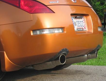

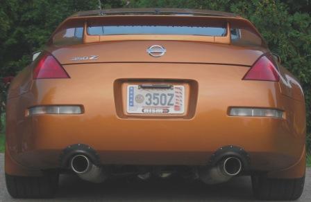

I ended up on the group buy for the SVRT 2.5 dual that does not use test pipes. I got it because:
Larger diameter than the HKS or the Injen Ti duals
Ended up liking the elimination of the test pipes - but that is not for everyone.
However, there were some problems with it that had to be rectified.
I will be post a review in the future, tried to do a sound video file but my video camera did a very bad job of recording the sound for some reason.

Hey Gringott......I can't really tell from the pics, but is the exhaust angled or straight? Looks good though.
Old Aug 21, 2006 | 07:02 AM
gringott's Avatar
gringott
Posts: 3,460
Likes: 18
From: Kentucky
There is an angle to the mufflers, not as much as others I have seen, but there is some. Diameter of the exit pipe is slightly smaller than NISMO tips.
