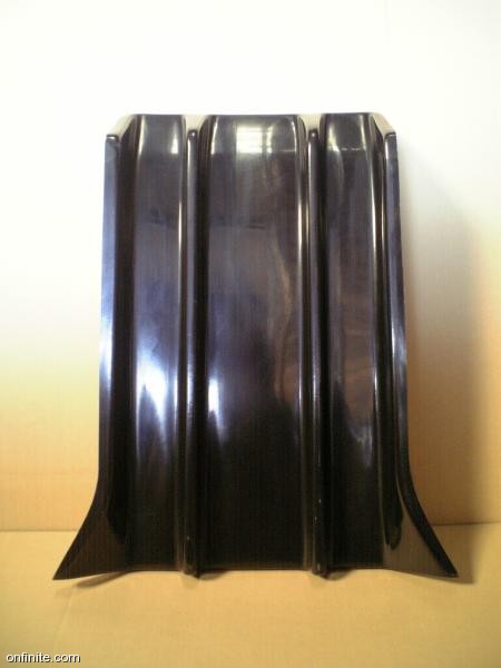

Further good news for the performance enthusiast is that the APS High Output Exhaust has provision for the stock wind deflector on the leading side of the muffler assembly. The stock wind deflector is an aerodynamic aid that slices through the turbulent under body air flow and channels air under the muffler.
So according to APS I was right, nice system, 4 bolt flanges are a plus. I am surprised that they did not bother with an H or X pipe.
I am thinking of making a pannel similar to this, probably starting from the rear diff all the way to the bumper.

A while back I remember someone was gauging some intrest in a carbon fiber diffusor similiar to the one that you just pasted. If I am not mistaken they took one off a Ferrari and photochopped it onto the Z. Looked really good and like it would work really well also!
