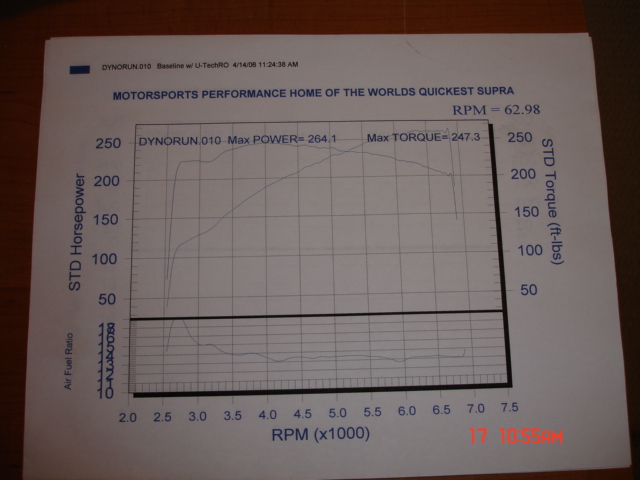

Hey guys,
Finally was able to dyno my car with the addition of the larger Maf housing.
The previous dyno i had was done in STD so the new dyno graph is setup the same.
Here is the old and the new.
The only other thing that was done to the car after the first dyno was the 4.10 gears and the larger MAF housing and intake pipe.. Plus i had to retune everything with the UTEC.
Looks like i made around 13 hp and 12 tq.
Later
Todd

OK, and one more time for dummies... which MAF housing, what intake pipe (diameter) and what injector size?
Hey Silo
The housing is off of a Ford Lightning a believe. Stock Injectors and the pipe size is listed on the first page in the first post.
