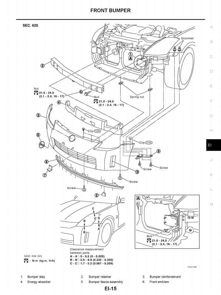

there but not sure if 06s are the same....

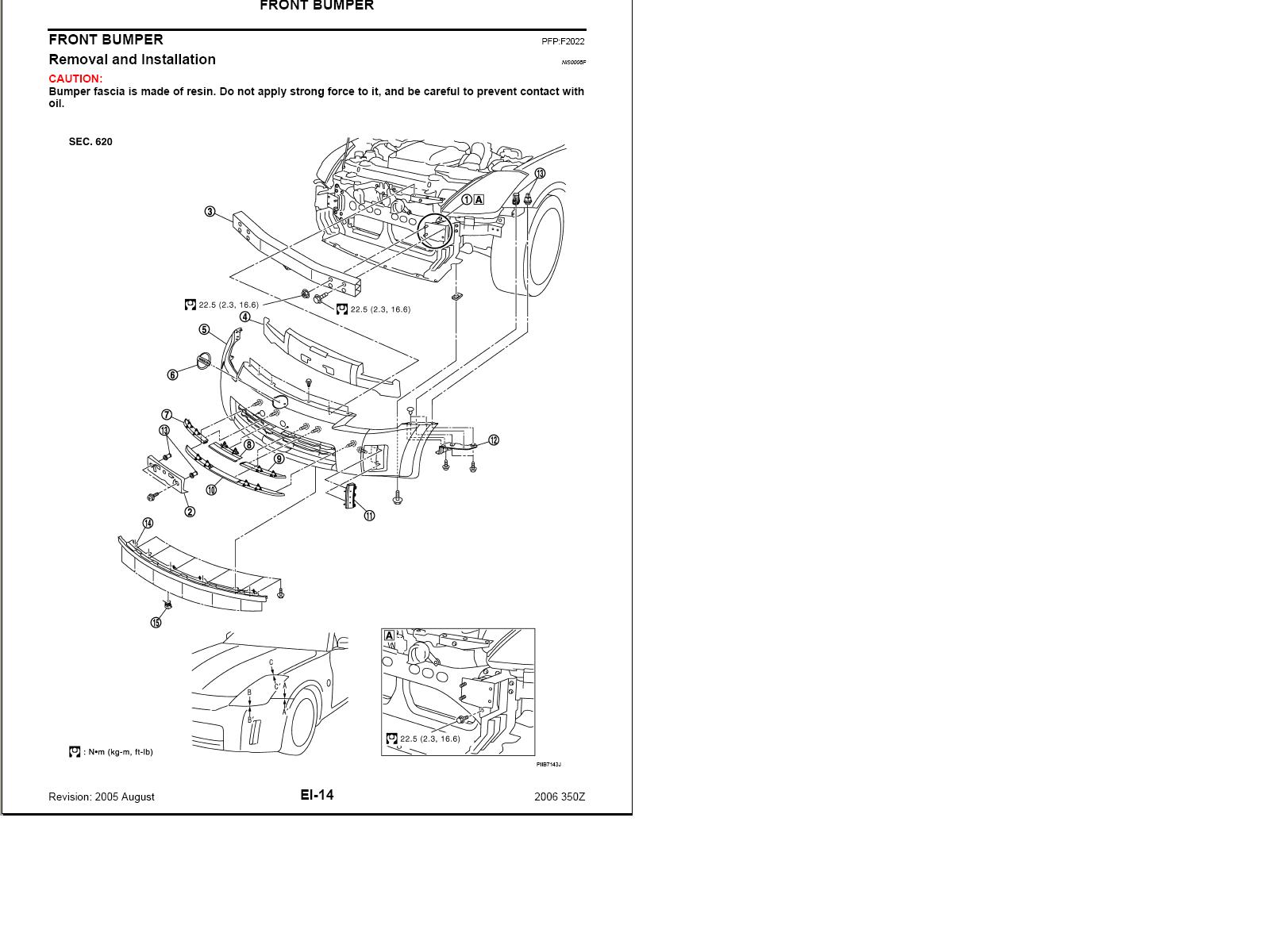

I didn't do a compare to the page jeff_chen0209 gave you, but this is from the '06 manual. It should get you where you want to go with this.
Thanx a grip load! looks complicated but im lookin forward to tryin lol
