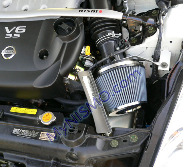

Hey guys. i was about to order an intake today (JWT popcharger). and i asked my friend who's really into the nissans. and he said not to buy an intake. it would make the car slower? cuz the stock one is good itself?
is this true? i just bought the car about 5 days ago and i just wanna throw somethin into it. so is it true what he's sayin? or should i buy it?

https://my350z.com/forum/2003-2009-nissan-350z/197329-the-top-100-common-questions.html
Q: What are some advantages and disadvantages of different intakes? Should I go for a cold air intake (CAI), a JWT popcharger, or any other suggestions?
A:
Stock intake:
pro: sucks COLD air from outside your engine bay, has low pressure losses, OEM paper filter is very good making this the cleanest intake for your engine
con: once you start flowing a lot more air in general, stock intake box may start to be restrictive.
JWT popcharger:
pro: can suck higher volume of air compared to stock
con: sucks hot air from engine bay and heat shield does not really help all that much in preventing it from sucking hot air. People have reported a problem stalling when travelling at high speeds and putting the car in neutral with this intake.
Long tube CAI such as Nismo, Injen:
pro: sucks colder air, (note...so does stock)
con: More pressure losses due to a longer tube. This is a fact of life folks. More bends and longer tube = more pressure losses. In fact, long tube CAI's have even shown horsepower LOSSES on a dyno.
K&N typhoon (short tube like stock intake / JWT popcharger, but includes a front-mounted scoop):
pro: cone-type filter should suck a higher volume of air compared to stock. attempts to offset JWT popcharger's hot-air syndrome by incorporating a cold air scoop.
con: hard to prove that the scoop is actually effective
HKS Racing Suction
pro: Shorter tube like stock, higher flowing filter
con: People have stated that the install is difficult, price is rather high for what seems like a minimal improvement over JWT popcharger

https://my350z.com/forum/showthread.php?t=197329 read #9 it will tell u why ur friend said that. pop charger sucks in hot weather but nice in cool weather. i just got it cuz it was cheap and simple mod.

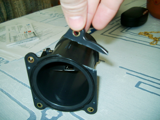

be careful of the installation, remember that 4th bolt in the back. I didn't know and broke mine on my 03 Z I used to have.
